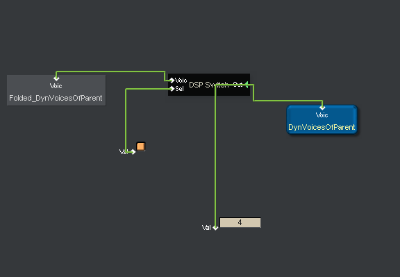

Implementing this small circuit will allow for devices to have an input designated "power". A corresponding power switch device turns on the dsp (with the correct voices selected in live bar) or off. Now you no longer need to fiddle with voices on livebar or delete idle plugins from a project. just turn them off and on again when you need. in fact, each person (hey look at you all the new sdk people) - can take a simple simple simple homework sdk learning project to make his own power button, or an array of them. You can make a Power matrix where one is master power, but has extra outputs.
OS DSP Switch 1.zip
(5.86 KiB) Downloaded 677 times
- you need to fold the dynVoicOfParent that is connected to your livebar and then export the parameter
- then pull out another dynVoicOfParent and connect the dsp switch as shown.
- if your device is 1 voice and doesn't depend on voices from the livebar, you can just delete your original one from your project, and place a controller pad dummie with the value of 1 at the voices input of the dsp switch.

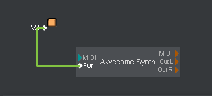

example of the circuit for a power device to switch on/off devices with a power input. just connect the pads to on/off switches on a panel and you have a power device with 1 master power affecting all, and 5 individual or group powers.
of course all the pads need to be exported so as to end up with:

so imo this could revolutionize how you think with your projects in scope. how you save what you save how you arrange yourself. especially useful if in a live situation :) but every dev including sc have to get behind adding this to plugins and having it a sort of must!
