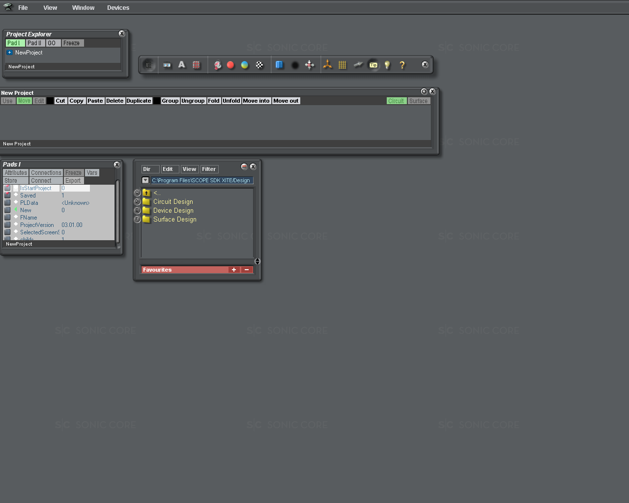

Sdk 6 won't run with registered devices, sdk 5 is fine, but has random crashes with some modular patches and some devices and also it's not optimized for screensets, another problem with sdk is that it can't manage dsp assignments on protected devices(you must fold a device to accomplish it), so i prefer using sdk for packing devices and scope 5.1 for production.
Also the module protection bug on sdk5 forced me to use 2 different installations, one that works with all modules to be used for developing and one that is able to protect devices, but that is unable to open everything.
The folding option of scope sdk is the tool that scope 5.1 is missing.
SDK 5.1.png (98.05 KiB) Viewed 2542 times

sdk 5 at the moment is the one to go for the xite.
Only problem is the protection bug, so if you need to develop devices to be protected, then you need to apply the "view protection patch" from here:
ftp://ftp.sonic-core.net/software/scope ... 0patch.zip
wich contains a file called PepBasic.dll to be placed inside App\Bin\PepBase
and also to let it work, you must delete a file called "PepBase.idx" (it will be re-generated after scope sdk starts).
The problem with this is that scope sdk will run into error popups and will not be able to run all devices, so my suggestion is:
install scope sdk (this is your main functional sdk installation)
copy the sdk folder and rename it, then apply the patch and use it only when you have devices to be protected.
Better solutions are welcome if someone discovered it :wink:
also sdk 6 is useful if you want to export some dsp as device and then use it on sdk 5.
