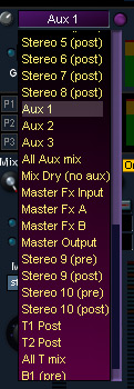

Rec Channel: By using the Rec Channel Source menu, you can send any FP mixer channel to be recorded, pre-or-post pan/effects, and especially take advantage of several options to record Mono channels. Rec channel is a time saver that allows to make connection to you asio destination once only, and then change it with a menu instead of manually. I did this after years of recabling asio dests, and being really fed up doing this all the time, as i generally record no more than 2 asio tracks at once... So i've put the various recording "scenarios" inside the mixer, to save my time by not reconnecting things when i change the recorded source.
For example, you play guitar, bass etc, and you play it with inserts in the FP mixer. With the rec channel, you can record the guitar dry (from inputs) or after the inserts. You can also record 2 mono channels at once (for pseudo-stereo, or if you play+sing at the same time, or if you have a friend at home playing with you etc)....
You can also record the bus pre/post, or only the aux effects, or only the mix without the aux effects, and other options.
Especially, I like to record the master stereo track "pre-master effect" where I have a FAT Insert/Lim Fat and compressor for mastering. So i record the stereo mix without those effects, which allow to refine them later if needed. There is also an insert that can be used to insert a spectral analyzer, or anything else to be recorded like a limiter/compressor (but i never use this function myself).
There is only 1 rec-channel output, that's the only problem i found so far , but then you can also use the individual outputs if you record more than 2 asio channels at the same time. at least the rec-channel will avoid recabling the 2 first asio inputs...

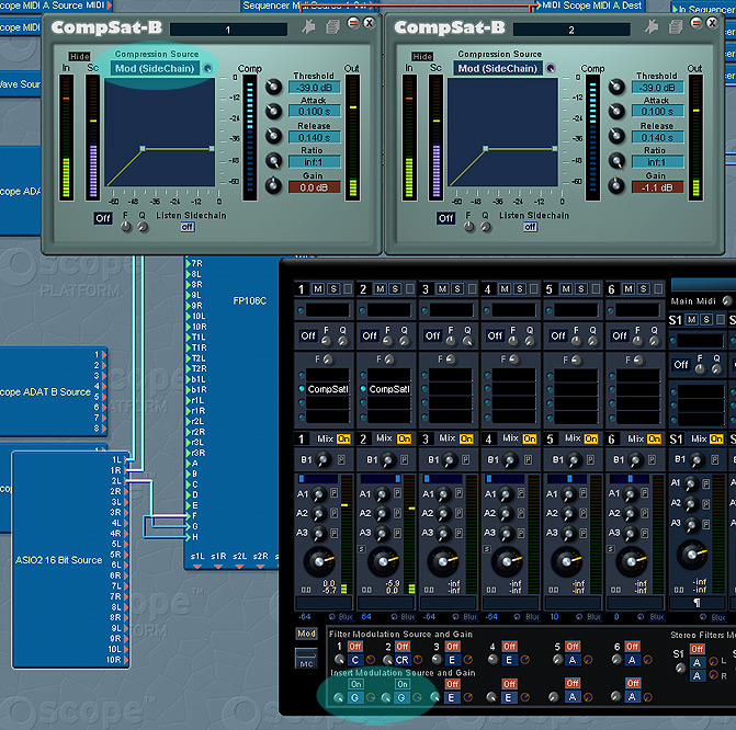

RP100, here is a pic for side chaining on 106C, it works on any modulation input (A to H)
don't forget to put the mod-gain to max in the mod inputs settings.

- Try those settings... CompSat or CompSatB is the same ("B" has filter on sidechain input)
- 106-C-sidechain.jpg (212.21 KiB) Viewed 2364 times

- The Rec Channel allows to record the individual Aux too. Especially, allows to record at a different volume than the monitored track.

Brotha' Man Medhi,
I have tried the CompSat B's because of the filter on the inputs.
I am showing everything totally MIDI controllable and audio is present.
I only had to change the channel number on the CompSat loaded in Ch. #1 from 2 to 1, as both instances of CompSat loaded up with slot number 2, but other than that everything is flawless.
My Analog synth in the low end is just so overpowering, that I must use the actual cabinets I use during a live gig because all of the nearfields and headphones cannot accurately reproduce these fierce freaquencies and SPL's.
I thought by using the CompSat's as a sidechaining device, that I could have the low notes on the B2003 stand out more when doing this, but I am at a loss as when I am playing the synth through the stereo channel 10, I am not sure how I am suppose to lower those frequencies when I play the B2003 simultaneously?
I have also set the Mods in the SE-1X channel to match the ones in the B2003's channels, but I am not hearing the Analog synth ducking out.
What am I doing wrong?
BTW this is an awesome tip. How would anyone figure on loading a stereo compressor into a mono channel to achieve sidechaining without cluttering up the project window ...? Brilliant.
I have started loading other stereo effects into the mono effects folders that might work too.
The DAS SC Gate w/ the key filters will be tried if I get this working.
CiaoMein,
CiaoMein,
Re: SpaceF FP106 mixer questions...
I don't think your are doing anything wrong, just that my sidechainable devices can't work in stereo, because it would need an insert (and insert slot) with 4 inputs, or more.XITE-1/4LIVE wrote:Brotha' Man Medhi,
Also, I don't have the dynamic routing that Vinco (or das) has, but I was told it does not save / restore connections correctly when reloading projects so i really prefer not to use it (i haven't tried that yet, i mean i haven't checked for myself this project reload thing or if there is something to do to improve it, but if something doesn't restore in project (not even speaking of presets), then it just cannot be in a spacef device anymore). It could be fixed in scope 5 so that could be used on my devs in the future. for the moment, they are very buzy at SC and i don't want to disturb because the faster they release what they have to release, the better. So I think that, for stereo sidechaining, Vinco and devices with this dynamic sidechain selector is all that is going to be available at the moment.
The alternative, which will not compress, but remove some bass freqs, is to activate the stereo filter to Highpass (HP): i see in your picture that it is not used. But it will cut some bass, not duck them.
I did that device which uses midi CC (S-Filter-1) and that can be used for sidechaining, but using midi to send audio signals is like trying to cut your steak with a teaspoon.... can work, but not approriate...
Another alternative is to use a sidechainable stereo compressor before the mixer, in the project instead of an insert (and you just made me realize i don't have such a device
