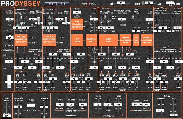

Plugiator Dev MidiCC sheet for Doepfer Drehbank or similar
Just print on A4 and plastify it
- snapshot
- Prodyssey-Plugiator-02-A4.jpg (121.6 KiB) Viewed 29279 times
- Prodyssey Plugiator 02 A4.pdf
- Updated 08/10/07
- (1.77 MiB) Downloaded 894 times

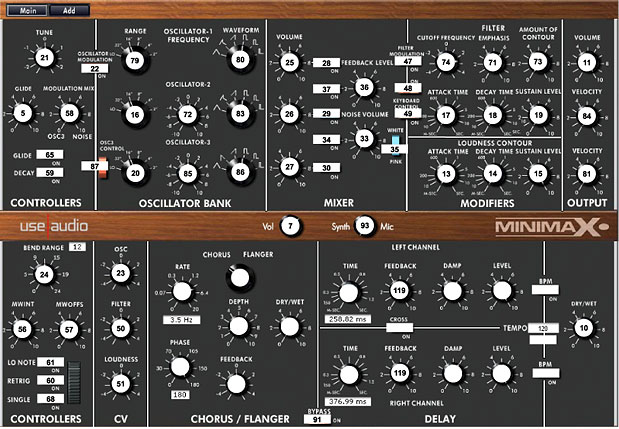

An this is for Minimax
- Snapshot
- Minimax-Plugiator-02-A4.jpg (86.7 KiB) Viewed 29278 times
- Minimax Plugiator 02 A4.pdf
- (337.36 KiB) Downloaded 866 times

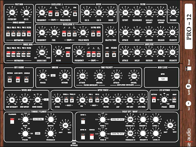

Re: Plugiator Plugins MidiCC sheet
Pro 12
- Pro12-Plugiator-03-A4.jpg (118.24 KiB) Viewed 29247 times
- Pro12 Plugiator 03 A4.pdf
- (720.47 KiB) Downloaded 883 times

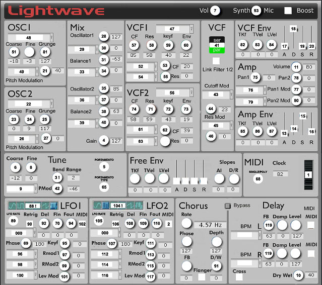

Lightwave
- Lightwave-01-A4.jpg (110.99 KiB) Viewed 29244 times
- Lightwave 01 A4.pdf
- (427.94 KiB) Downloaded 944 times

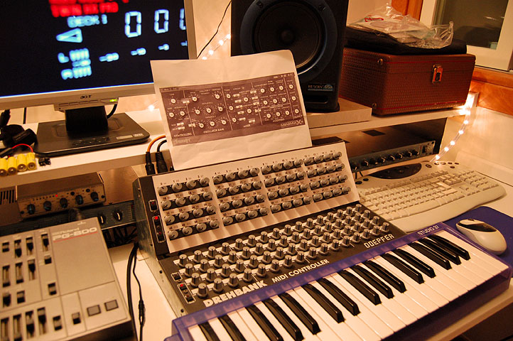

Re: Plugiator Dev MidiCC sheet for Doepfer Drehbank or similar
It's a good method of work for systems like this or similar.
Also suitable for Scope Plugins, just only to assign the correct controls to the pots/faders.

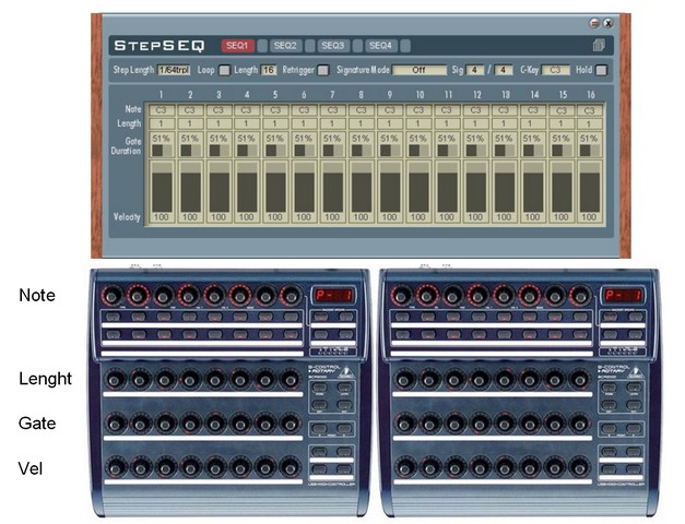

Nice Ones.
It would be usefull for my adaptation to the Berhinger BCR 2000 and Novation X-station.
Thanks !!
Thanks !!
Love that set up of yours.
Doepfer was way ahead of the pack.

One can just notice there is no way to directly control the LightWave Free Env with CC messages.
This was possible with the NOAH using some Polyphonic Aftertouch Messages.
On the other side the CC messages for controlling waveforms selections did not work on the NOAH.
Deuce.
Thanks once again.
CheerZ

Yep, I've writted only CC controls, the others (leaved blank) are PAT controls.HUROLURA wrote:One can just notice there is no way to directly control the LightWave Free Env with CC messages.![]()
Deuce.
Thanks once again.
CheerZ
Sadly S|C and USE Audio used PAT instead only CC
Anyway the controls with PAT are mainly minor controls, so if U need to tweak use the Plugin Manager
At 99% the most used pots are cutoff, resonance, oscillators and LFOs.
