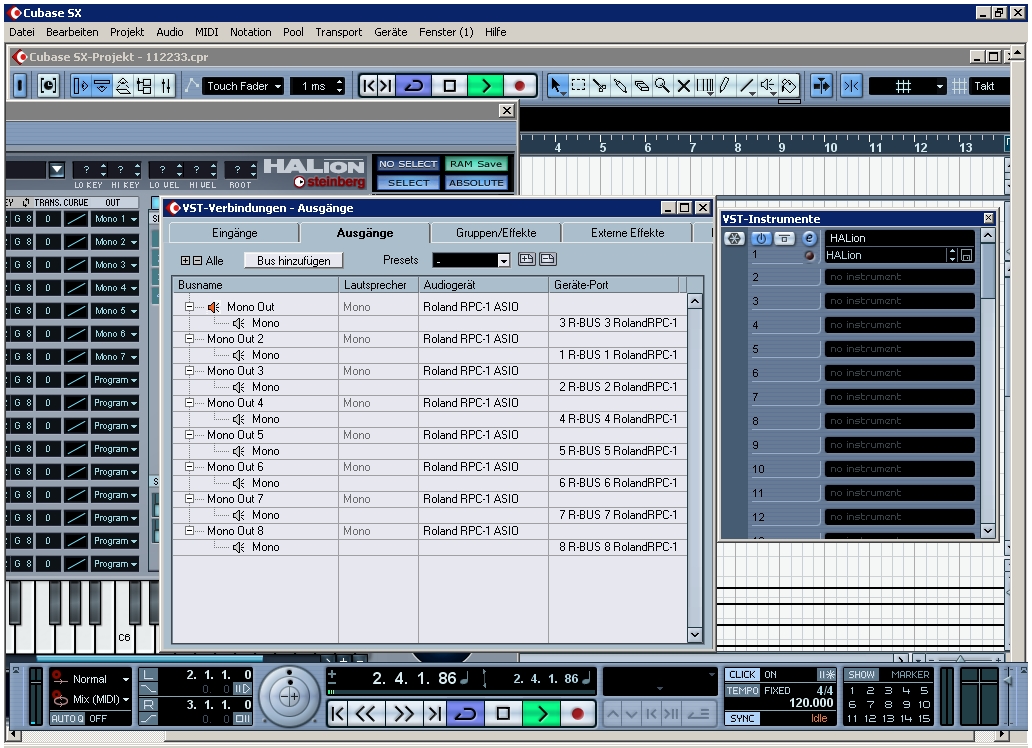

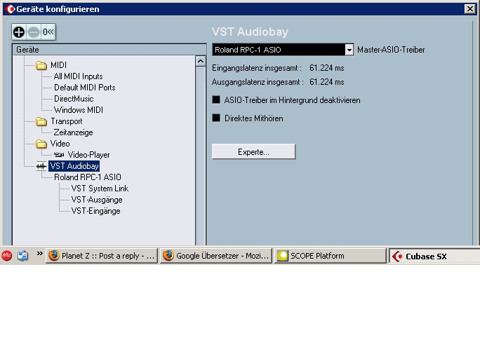

thanks for fast answering, bud Its better for me If you make an screenshot howe looks the scope routing window from you writing about, It to many ASIO Sources and to many other sources and DESTs, I do not know with one is the right one, and I dont know whats happen if I use the 24 bit ASIO Sources and whats the menaing of ASIO 16 oder ASIO 64 or ASIO 2 Bit ........ its unbelieveble , Can I use my 16 Bit samples if I take the 24 Bit ASIO DES0T or SOURCE, and howe lokkonig about the 44 khz or 48 khz on my digital mixer and by scope samplerate!?!?!? So You see its to many questions , so its better vor everybody If you make an Screenshot about the Roting Window by scope howe to look tahat by 16 Bits and howe its have to look if you use 24 bit, and write what is the different betwwen ASIO and ASIO 2, why are there 2 times ASIO arts???

hey astromen, thank you my friend, you are realy realy very very much helping me, special thankz to you for showing me howe its look an 8x ADAT by Pulsar 1 Scope 4.5 in Routing window, special thankz for all the screenshots, you are realy great meeen , I can feel it that you over 5 years helping people in this forum, and you helping me ,too.

hello my hero friends, thanks for to many helps, but Im calling today the Roland Support germany, and Im telling him about the VM 3100 Pro Mixer Digital In and Outs, and he tell me " no way, the roland mixer has not ADAT interface, okay its have TOSLINK Cable in out, but if you need to use this In s and Outs like an 8x ADAT IN and Out so you to have buy an DIF-AT Box to switsch it between the RMBD2 OUT from Roland Mixer an the ADAT Element like Scope ADAT INS and OUTS" Im shoking now!!!! I can not believ it, Im looking by ebay about this DIF-AT box, this F**cking box costs more than used Roland VM 3100 Pro Mixer, 320 Euros, SHOK TOTALY
I can not believe it, Im buying this Roland VM300 Pro to Use the ADAT ins and Outs with my Scope Pulsar One Card.
Im Asking him why the Roland VM3100 gets the PRO name, becasue it have 12 Mono Channels and 8 Digital Channels, but not via ADAT, so he tell me that I have 8 channels more if I use the RMDB-2 system in the roland mixer, so its an PCI card with R-BUS cable to connecting on Roland mixer, and here I can use 8 digital Ins and 8 digital out on the channels 13-20 in my Roland Mixer.
So Im changing the Clock Source in my mixer on RMBD-2 and connect the R-BUS Cable in the PCI Card that takes the name RPC-1 Card, and the roland mixer show me the messege "RMBD-2 Locked", so Im starting the cubase and look first in the audio device system, here Im changing the audio device from scope to RPC-ASIO and now I can see 8 times Ins and 8 times Outs, but with 61.224 ms latence
, so Im startin an new 16 channel midi Project and look first about the Cubase Ins and Outs, here I can see now all 8 ins and outs from RPC-ASIO, but thr problem is here is only the Stereo IN and OUT active, you can see it in the screenshot, the Active channels arte Red, and the channels they are not active ist in grey color to see, so I konfiguring my halion3 of 8 mono channels, ist work only of Stereo channels 1-2 and I can listen this on my mixer of channles 13-14, I dont know why the other channels are not in Red, not Activ!?!?!
- device system cubase.jpg (121.18 KiB) Viewed 1907 times
- Cubase INS and OUTS.jpg (542.1 KiB) Viewed 1907 times
