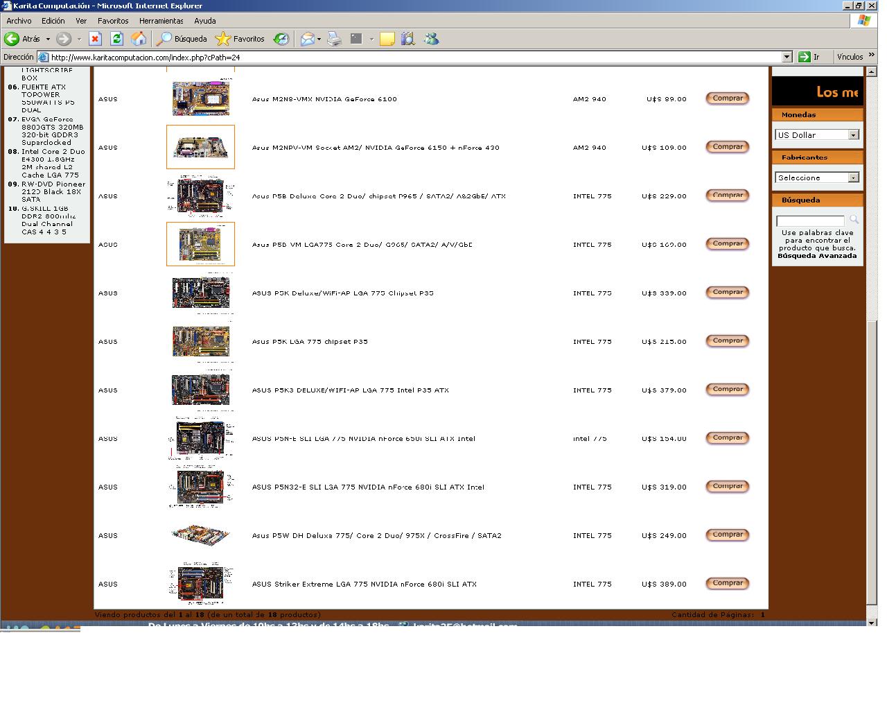

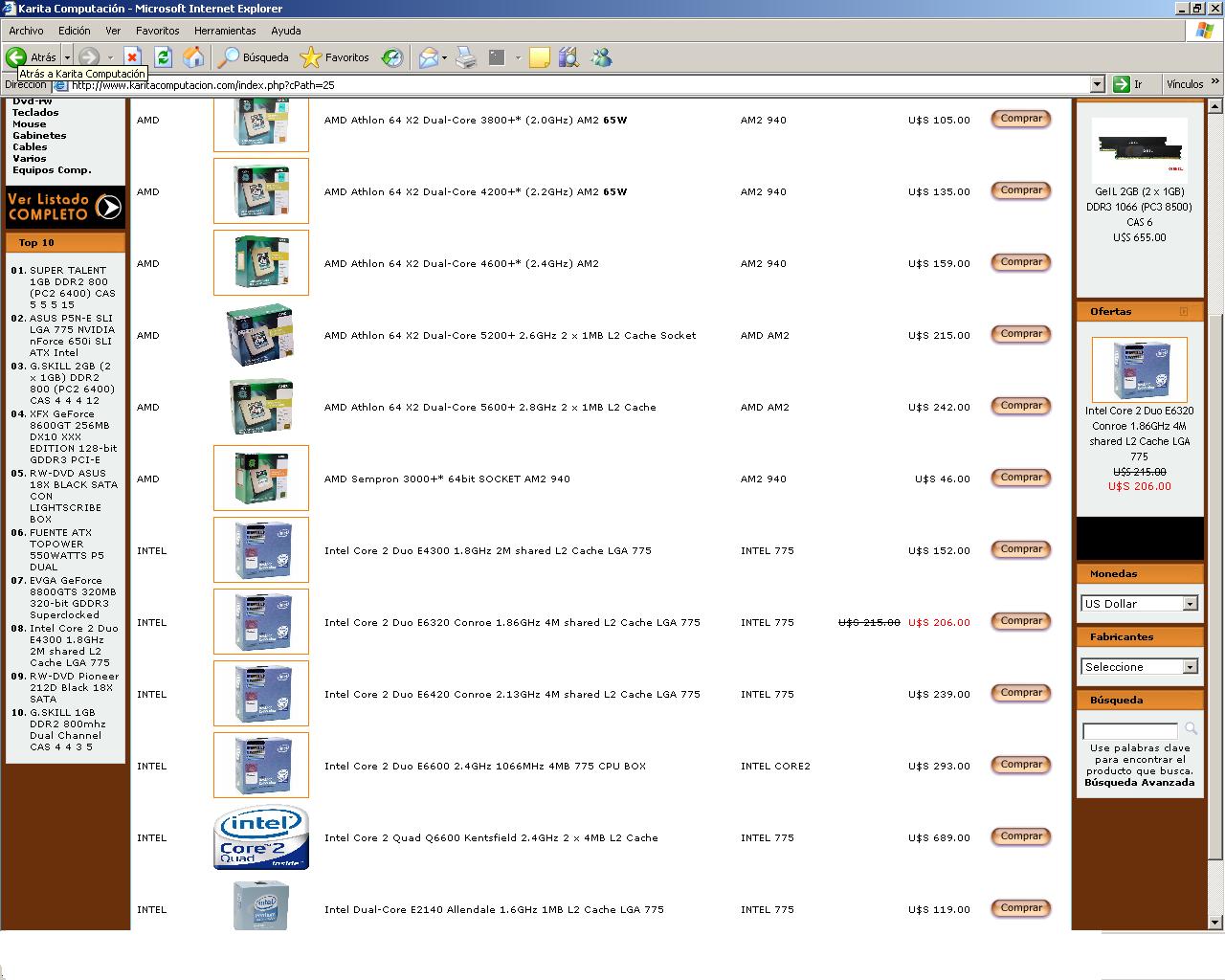

What do you think about this configuration?:
Mother : ASUS P5K Deluxe/WiFi-AP LGA 775 Chipset P35
Processor : INTEL CORE 2 DUO E6750 2.66 MHZ 1333 FSB 4MB
RAM : G. SKILL 2 X 2GB DDR2 800 (PC2 6400) 5-5-5-15
thanks!!!!

I just bought and set up a Asus P5K deluxe with Intel Core 2 Quad, and 4 gig Corsair Ram. Kicks like it's on steroids...
Only thing is. You need a pcie graphics card wich will overlap PCI slot 1 (if it got the silent cooler rib attached). This leaves you with PCI 2 and 3 for your pulsar boards and a really cramped space. I guess I might experiensing heat issues wich I (you) need to address.
Another issue is if you really need all the features the Deluxe issue gives you (2xgblan, wifi, etc..) I found myself turning of these features beacause of Pulsar stability.. But then againg the bios support 2 bios profiles which makes this board handy with a dual boot XP (one for Scope and one for other other stuff).
Why not Quad? Aaaahhhhhhhhhhhh...174 loaded SSL comp in cubase and only 50%cpu :D

wokrs fine even with a combination of duende, scope (p1+scope) and UADe (PCI express).

Thanks!!
I´ve bought :
Mother asus p5k deluxe, intel conroe e6850, corsair 2gb (1066), thermaltake tsunami., video geforce 7600 (dual monitor)
I`m testing ...
