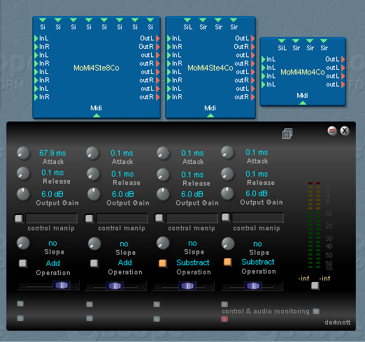

It's simple: (as I said, you might call it boring)
- Connect, lets say a whole background song through first L & R of 8x4.
- Then connect Voice to the sc 1.
- Set the EF reacting to voice-in as you like.
- Set substract, so that incoming voice pushes down background.
- Connect voice & out LR 1 to mixer
That should be nice for speaker apps in radio etc. I like to work with many groups being (very subtle) influenced by other groups (therefore the multiple ins under one surface), which gives a song some dynamics back that were lost due to compression etc...
It's not a 'real' compressor or expander, just a simple envelope-follower which influences loudness in positive or negative direction, but I'm nearly finished working on an insert-module which will make it react like a 'real' compressor.

Not really, but of course you can connect first 2 outs to 2nd two ins ... and so on... That way it would be multiple sidechains... to one signal way...
That's indeed how I used it once on a drumtrack, first HiHat getting kicked by snare, then dropped by bassdrum
The stereo VU is somehow irritating: It's settable for each control or audio way.
