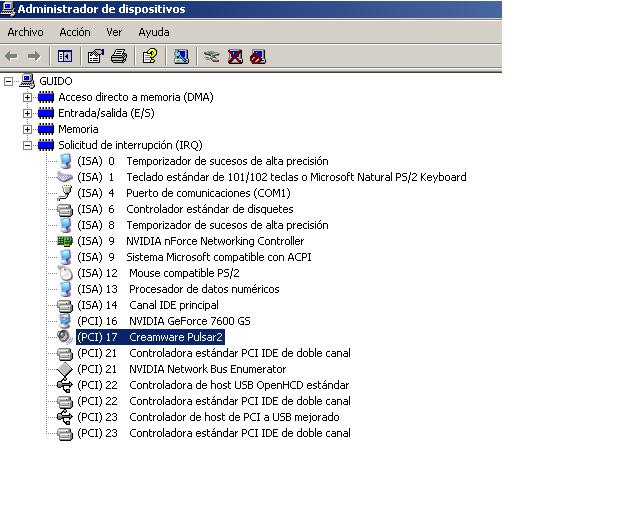

first, what is your card sharing an irq with?
second, does your problem only exist when midi is connected to the card?
Guido
Posts: 17
Joined: Tue Jun 12, 2007 4:12 pm
Post by Guido »
Thanks Garyb!!
1) There is only one device in IRQ 17
2) I didn´t , the problem exist with and without MIDI (Korg X5) anyway I´ve inserted a MIDI FILTER (Filtering active sensing)
lista de IRQ.JPG (61.64 KiB) Viewed 4654 times

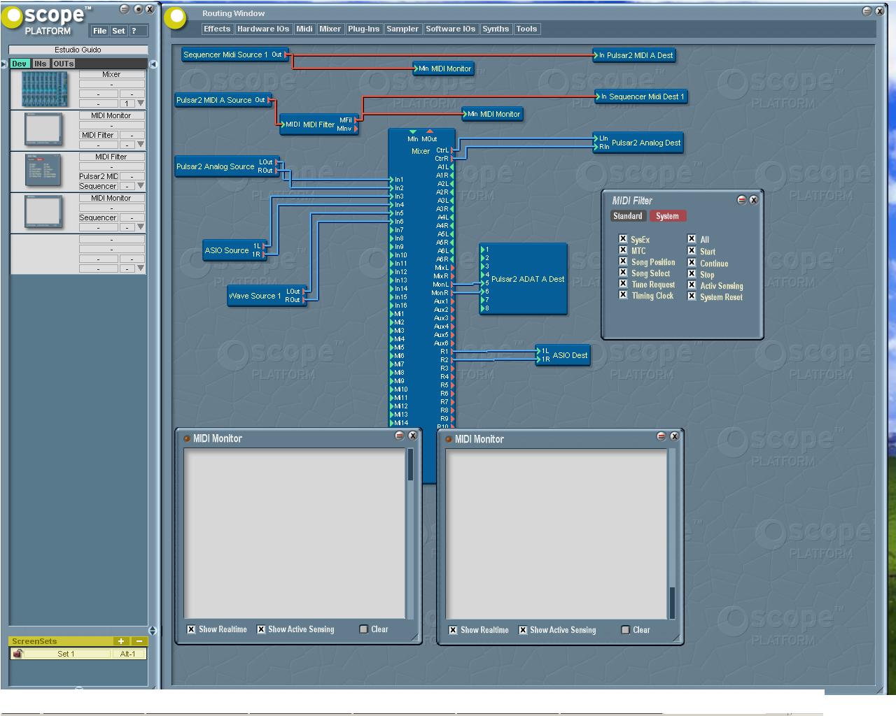

tgstgs
Posts: 526
Post by tgstgs »
while watching your jpg i find strange to see a bigMixer v2 which is no longer part of SW;
maybe it has a reason why?
if its realy a bigmixer V2 you can try to change to a uptodate mixer!
maybe it helps;
good luck
Guido
Posts: 17
Post by Guido »
I´ll try with the mixer STM 1632 or Control Room but I don´t belive that the problem happen with this...but I´ll try too.
Thanks! tgstgs
