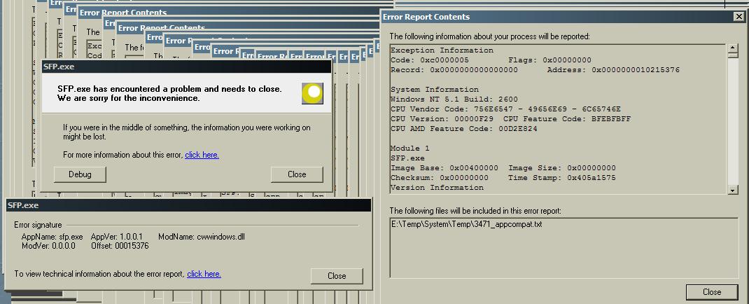

Just downgraded to Scope 4.0 with the same results
See image for error message. I also get this error in Scope 4.5.
