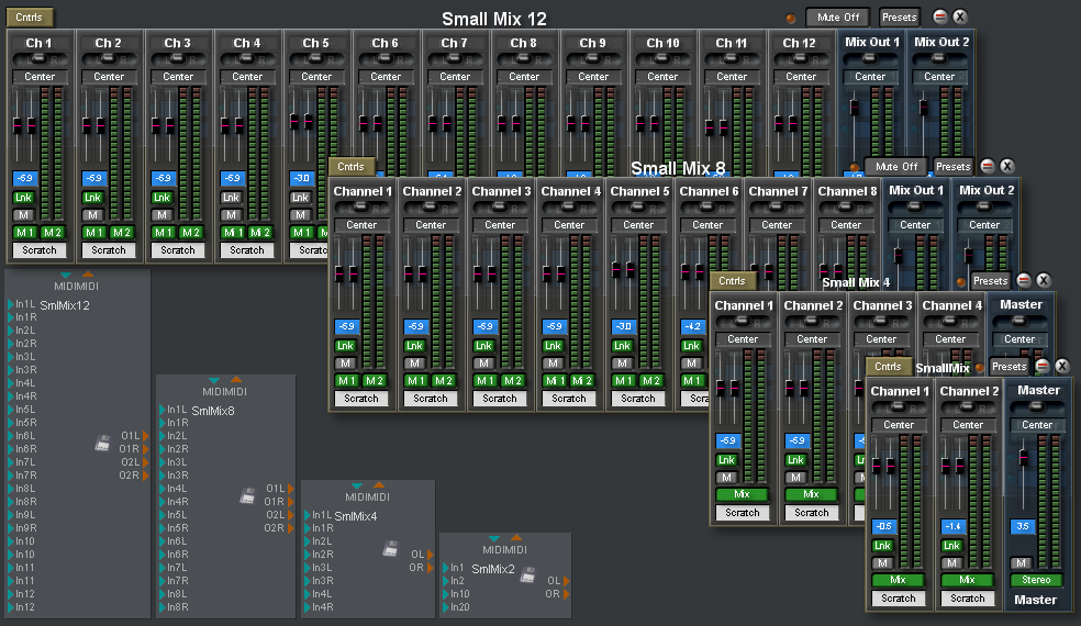

I have been working for a while now to produce mixers with minimum screen footprints,
I am in the middle of developing a number of mixers to meet this need.

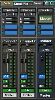

Here is the most basic one that should meet your need.
Press the 'Cntrls' button to get access to extra controls and to add Fxs.
I have not done a lot of testing as yet, so if there are any issues with the mixer please let me know.
regards
maus

I am building a family of these mixers 2, 4, 8 ,12 and 16 stereo channel models.
Most are done, still working on the 16 channel version.
Also have not really tested them as yet.
regards
maus

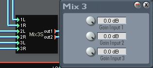

Currently I´m using "Mix3S" (see attachment) for summing of 2 small mixers and WAVE Out in my latest XITE project.
It works, but your new creation is more advanced in regards of control.

The 4 channel version doesn´t work well on my laptop,- Win 10 Pro x64, latest build, update, latest runtimes etc..
There are graphic issues in the top row of the mixer (Cntrls / SmallMIx / LED / Presets).
I´m unable to grab it there and move inside Scope environment.
Instead it results in weird graphics when I click on it in that region.
I´ll come back to you w/ pics ...
Next issue is the input levels which I compared to the project I use the SpaceF Mix3 device for summing 3 stereo sources (see above post).
I´m using -3dB "Gain Input" w/ Mix3 for each of the 3 stereo signal pairs and get proper distortion free levels at the output.
With the SmallMix 4 and an input gain @ 0dB,- there´s almost nothing at the output.
I´ll try to make pics too.
This is just only pre-info and maybe you might have time to investigate.
I used SmallMix 4 in the same project and just only replacing SpaceF´s Mix3 and I only tried to compensate levels w/ the faders on SmallMix 4.
So, I didn´t change anything gain stageing w/ the other devices in the project.

Hi Bud,
Yes I have seen these issues too, just haven't got around t investigating them as yet.
I will have a closer look when I get a chance.
The gains are definitely not right!
The graphic thing happened to me as well, but only once.
I built them that way so the schublades hide properly whilst still leaving the top level controls (presets, etc) visible. I know it stops you from grabbing these devices by the top section of the graphics.
I will have a look at changing the layout so they work better.
Thanks for the feedback.

The updated tiny 4 channel mixer works better,- but I still lose level compared to SpaceF Mix3S (w/ -3dB input gain) and the S|C micro mixer.
I still have to crank up the master fader more than the channel input faders,- also when these are @default levels.
The meter scaling seems to be wrong too and they should work like the meters in S|C mixers do.
P.ex. when I set the faders to 0dB or less,- there´s barely level at the stereo out and in the analyzer/level meter I use between SmallMix4 and the XITE main output.
Otherwise, everything works and the graphics issue (top of device) is gone.
Here´s the general level meter stuff from Scopev5 micro mixer manual:
I´d like to get this right, last but not least because DSP assignment/ASync on XITE is better w/ the same project and compared to SpaceF´s Mix3S.
I now hope I´m no too picky ...
And,- I´ll check the stereo switchers later.
