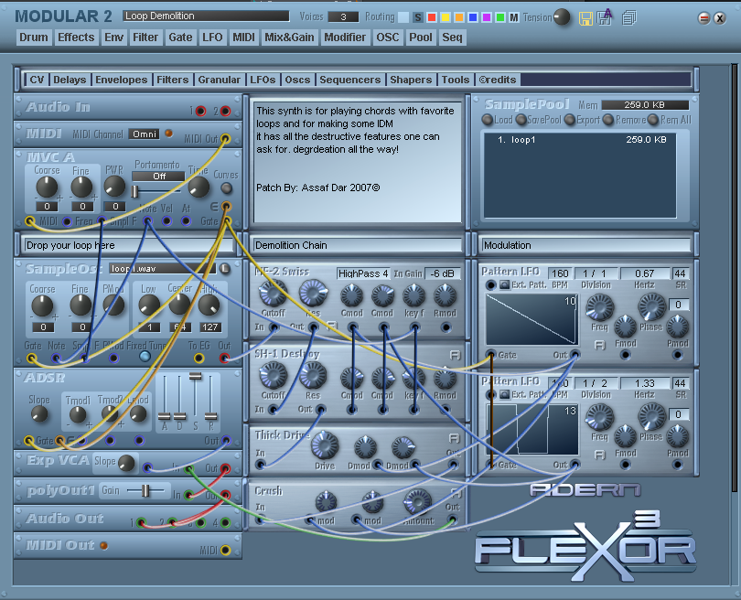

Modular Sample Player
Does work for some seconds, but at some point gives a bluescreen and reboots.
This Patch for example

tom the sample players work good here.
can you do a test plz with this
http://forums.scopeusers.com/viewtopic.php?f=16&t=35241
