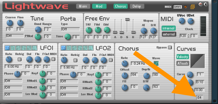

I noticed two minor graphic issues.
1. The Meterbridge and Notepad modules are still black:
2. The new Note field in Lightwave doesn't disappear when you switch to another page (and it's missing the inner shadow):

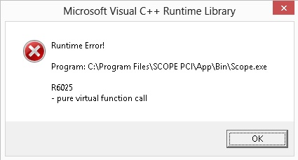

Scope 7 Plug In : SC-BrickWall EQ Crash :
OS : Win 8.0 x64
HW : Scope XITE-1D
CPU: i7 4790 (not overclocked)
MB: Asus Z87
RAM: 16GB
ULLI : 12ms
Sample Rate : 96KHz
Reproduce: Drag and Drop SC-Brickwall from device menu (Effects/Stereo/EQ/SC-Brickwall EQ) to project window.
R6025 Crash
R6025 Crash
Posts: 23414
Re: Scope 7 Bug List
it's ok, here. perhaps something from the v5.1 files if you merged them?
i don't have an XITE to check here atm.
maybe if you repaired the Visual C++ library... you could rerun the installer.
garyb wrote:it's ok, here. perhaps something from the v5.1 files if you merged them? i don't have an XITE to check here atm.
If it works elsewhere I suspect its my OS, which has been infected and cleaned by SpyHunter & hardly any OS patches installed. Next workstation & new OS I suspect it will work.

I can load the Brickwall EQ here on my XITE-1 without problems. I even tried it with 96 Khz.
I'm on Windows 7, 64-bit and did a clean install of SCOPE 7.
I tried at 44khz and it still happened. Its definitely my workstation.
