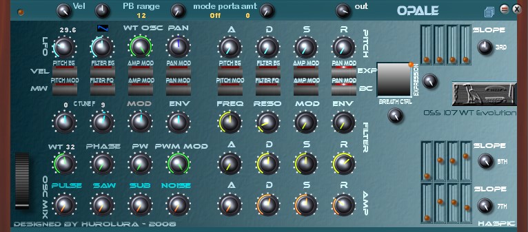

2nd beta release ... hope this one is better !!!
CheerZ
CheerZ
- slight control surface redesign...
- opale 2nd release.jpg (83.89 KiB) Viewed 14667 times
