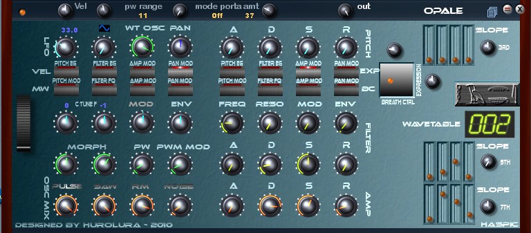

OK Guys,
After some more fight, here is finally the Opale nearly like a wanted it to be (Yes I Know, it tooks me a few years but now I hope this one is for good).

Re: Opale - OSS 107 WT Evolution for summer holliday beta te
2nd beta release ... hope this one is better !!!
CheerZ
CheerZ
- slight control surface redesign...
- opale 2nd release.jpg (83.89 KiB) Viewed 14655 times
