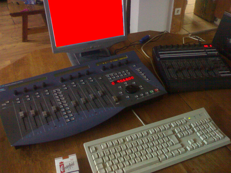

i also own a behringer BCF 2000 and let's say that the SAC is much much better looking than the BCF !!!
the BCF looks quite "cheap" in my studio while the SAC is very "high class"

- SAC VS BFC
- SACVSBFC.jpg (108.56 KiB) Viewed 3750 times

- sac5.jpg (360.07 KiB) Viewed 2946 times
