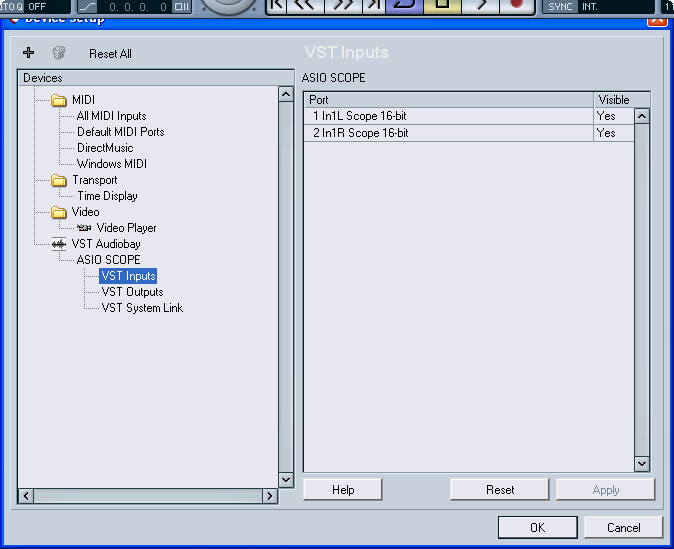

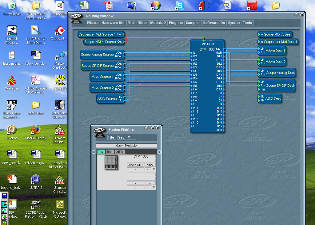

can you take a screenshot of your routing window and post it?
none of those steps you have taken have anything to do with your problem. the windows speaker control is NOT connected to scope. scope is not a traditional sound card, and a virus is unlikely.
what about the scope mixer? is it showing level? what modules are you using with cubase and did you have them in place in the scope routing window BEFORE opening cubase?

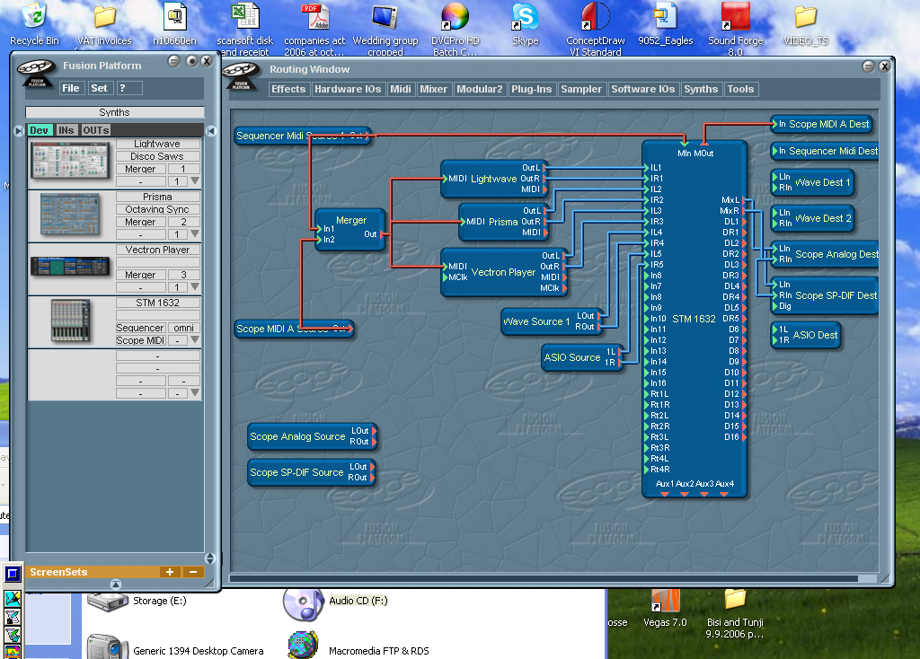

HI
I am sorry for delay inreplying but couldn't open Scope at all ssee post on this. Then I had to learn how to do screen capture so I bought Snagitt. So now I can take screen captures of whatever you ask. Here is the selction I have done so far
I am so grateful fo ryour help

well, if you have no sound out of the card, and your powered speakers or power amp is connected to the analog outs on the cable whip, and you see level in the mixer, then the problem is almost certainly in the real world(speakers off, bad cable, wrong connectors, wrong wire, etc). if there is level in the mixer, it MUST work....
you are seeing a sample rate in scope's sample rate window, yes?

ok, pesha migth describe the whole path of signals a bit more in detail:
- where is incoming audio plugged into (which cable goes into which jack)
- which software is used for playback of which source (scope synths, local wav files etc.)
- which program uses which drivers/devices
- which physical output is used to connect the speakers
- are other sound devices installed (onboard, for instance)
- do the meters in the scope mixers show anything
- are channels muted (something I run into every now and then since I have muted some ports in my default project
