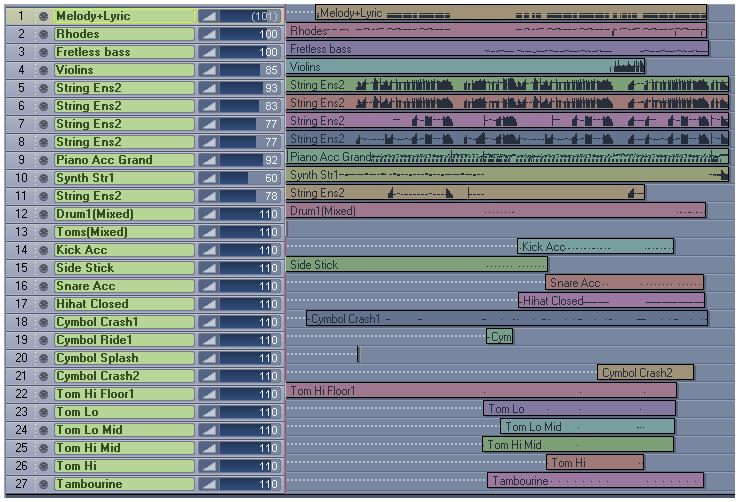

In case you are interest:
It is the "real world experience" @ mixing-down performance. I have 30+ DSP chips, totally ready for Scope samplers and synths as needed. Keep in mind that, once you have the Scope setup you will always want more and more DSPs that what you have in system.
Let me put an example soundtrack as "real world reference" (Done within Scope Boards) then welcome to have comments about Mixing's Quality.
Of course the MP3's quality is about 80% of its Wave-CD format.
The rough mixed:
http://www.planetz.com/forums/viewtopic ... highlight=
The Final Mixed as follows:
BTW, If Anyone is interested the (completed) MIDI file for this song then let me know.
Enjoy it,
LongStudios

LHong
Posts: 350
Location: San Jose, Ca. USA
Post by LHong »
Here we go
It is about 12 to 15 DSPs are used as follows:
The Total Tracks: 27 (14 Stereo and 13 Mono)
Rough Mixed: 16 tracks (Only 5 drum tracks are used) - 10/12 DSPs
Final Mixed: 25 tracks - 14/15 DSPs
Effect and Mixer:
Reverbs: 3
Echo/Delay/Chorus: 2
Compressor/Limiter/Expander/Gate: 4
EQ/Filter: 12
STS-Sampler: 1
GSIF/ASIO/WAVE Devices: 20-32 Channels - 32-bit/44.1Khz
Other/Dynamic-Enhancer: 2
Mixer: 24/48 Channels
LongStudios
