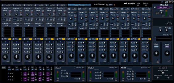

this is one of the "half-screen" version: It is the same as the "FB5 rotary" (the FB5 with rotary, and all inserts=2/3 of the 1152*864 screen) but this one with 6 mono/8 stereo (it's called FB8). As you may notice, it is not finsihed yet.
The presets for the "valve-n-filter" and for the inserts "racks" are of course compatible between them (exchange between channels, or aux racks between them) and with the FB5 bigger racks and external racks (cross-dev compatibility). It is not yet finished though , which is getting on my nerves because this is the one i'll use, and there's another slimmer version, and new satellites have to be made and also a redux of former filters that are good on synth but not optimal with the new format used here (it is still SpaceF Sat/EchoSat and RD compatible though, it is just that a few things can be improved here). plus a whole new BCR2000 layout (as the FB mixers have the same Midi integration as the MixSat C2, ie the big majority of what is seen on screen is not only assignable to any CC message, but also stricly recalled on project loading, allowing parameter feedback, hardware integration etc etc).
And no, it is not half-arsed, it is just half screen :-) (with half the inserts o, mono channels ok, i admit, and a less precise vu than on the FB5 -but still more precise andmuch less ressource consuming than the stock vus, and with the same readability of the various "limits" you might want to know about (-12/-6/-3/-1/-0.1 db...).).

There are 2 layers of midi CCs (scope allows 119 midi CC to be assigned: 2x119 CC numbers are available on 2 midi channels on the FAT mixers). 1 layer is for surface elements, and another set of midi CC is for the insert slots only. If you use the same midi channel on both layers, then the same CC number can be assigned twice (once for the surface, and another in an insert) and they will be linked. If you use 2 different midi channels, it is like having 2 devices in one in terms of CC mapping.
The "FP8 - Final Mixer" does not have the "fat valve" preloaded, but it has all the filters and modulators, and takes 2 full dsps+2 empty ones (that are reserved for insert slots : each of the channel section and the aux-n-mix load on their own single dsp and will not move from them. One version grabs a third OR a 4th dsp that is reserved for the insert slots (for ex, a master verb pro will load preferably on the less used dsp between dsp 3 and 4, same with other inserts). What it means is that whereas the internal elements are dsp fixed and compactly loaded on 2 dsps, the inserts are also loaded by preference on 2 dsp that are also fixed, and if needed on the next available dsp and so on in a clean and organized way (you can follow this on the dsp meter for exemple).
to be released not soon as some external devices have to be built .
This mixer makes the fattest, most controllable mixes w/ LFO's, CC's, etc. I have ever seen or used for keyboards period.
