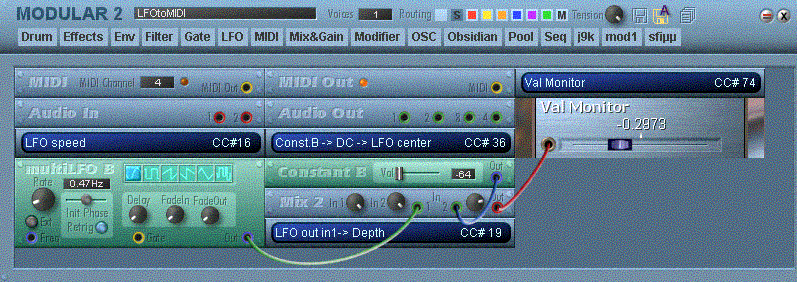

LFOtoMIDI, a simple CC#74 LFO generator
Post by at0m »
Original file probably lost, but recreation is easy from the pic. The same can be achieved with j9k's MIDI modules. Here's one with Val Monitor+

Post by at0m »
Send CC# 16, 36 and 19 to control LFO speed, LFO center and LFO depth. The modular sends out CC#74. Connect a synth to it merging with Seq/HW MIDI Source and assign it's filter cutoff to incoming CC#74. As you please, you could add MVC for retriggering etc. Have fun!
