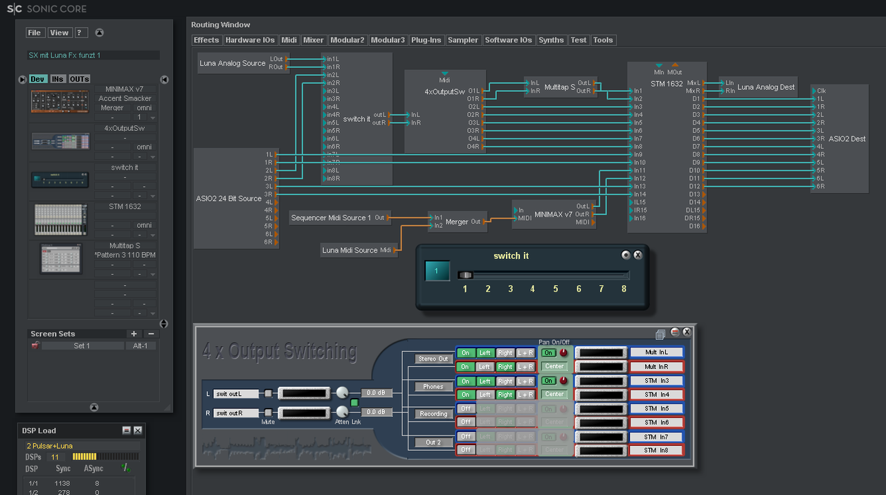

Routing and mixer questions:
The last weaks i did a lot of try and error with the routings in Scope.
Also with a lot of success.
My aim was to be able to record my shitty Fender Rhodes with effects from Scope.
The next step was, that i wanted to choose to record with and without effects, while listening to the effects.

But i managed to do with the help of 4x Output Switching from mausmuso:
viewtopic.php?p=356871&hilit=4x+Output+ ... ng#p356871
So a ton of thanks for that!
I also used an old plugin "Switch it".
I dont know who created that one, but a thousend thanks to that person as well!
I dont know if this is very sophisticated or dumb how i did it, but it works.
The screenshot shows, what I have done.
This is how it's done:
to get a wet recording (Scope effects):
in Cubase
in the track:
Luna in wet (=Asio 1 and 2)
output doesnt matter, but to listen to it later:
put the output on Rhodes dry.
additionally one track dry:
Luna in dry (=Asio 3 and 4)
in Scope:
Switch it on 1.
4xoutput switching:
push the first pair on
to have a dry and a wet recording:
push 1. and 2nd pair on
Scope synth bounce:
Switch it on 1
Input in Cubase:
6 Scope Bounce (=Asio 11 and 12)
Outputs that work:
Rhodes dry (=Asio 1 and 2)
Stereo out 3 (=Asio 5 and 6)
to listen to a dry recorded track with Scope effects:
select the dry track in Cubase, select output wet und put Switch it on 2.
Mute Channels 3 and 4 in STM mixer, otherwise you listen double.
To bounce this track with the Scope effect:
Create a new track, put the tracks input on Luna wet, the output on Rhodes dry or Stereo out 3, and Switch it on 2
Maybe there is a simpler way with a mixer?
But I understand too less of mixers.
Direct out, busses?
I mean, it works, but now there comes some desire like using a compressor in the chain and so on.
And this screams "mixer, please!"

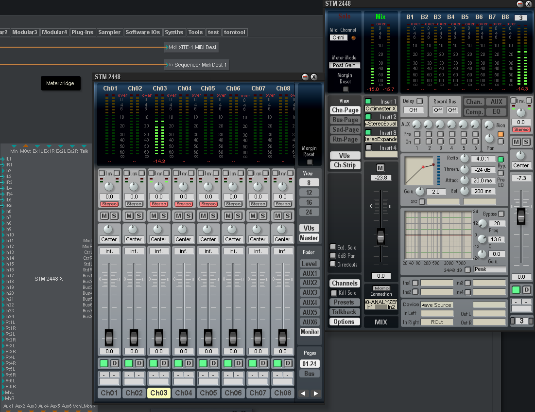

If your setup with switches works for you, it's ok. There is no right or wrong, you must be able to understand and handle the setup.
In the 2448 mixer, you can add inserts by clicking right on the white insert-label. To listen wet/dry you could either disable the insert by the green button in 2448 or within the insert. At mixers, there is controlroom, which is an other switching device.
AUX is often used to feed signals to an external effect box.
For mono/stereo i understand, that there are usecases for experts to use mono in some cases. I personally use stereo only. If it's a mono input, it just goes to both inputs. (But I don't consider myself to be the god of mixing, so feel free to ignore :) )

cemhot wrote: Sun Jun 08, 2025 2:14 pm As i updated from Version 4 to Version 7 without installing Version 5, I dont have the manual from Version 5.
I searched the internet and this board up and down without success.
Can someone maybe upload it somewhere?
https://sonic-core.de/downloads/#elf_l1_YXJjaGl2ZXMvc2NvcGVfdjUuMC9tYW51YWw
...auf Datei Rechtsklick dann Download
und herzlich willkommen zurück!

So the question is:
Can i use a mixer to give a line in signal to two different outputs, one wet, one dry?
That's why i was talking about busses and direct out.

According to this picture (taken from 2448 manual) you could use monitor to get the direct input to an output.
Aux seems to be affected by inserts, already.
The problem might be, that monitoring works only for a single channel. (two channels would be mixed into one)

Post by nebelfuerst »
Just click channels, then monitor.
Signal comes out on MonL and MonR at the bottom.
