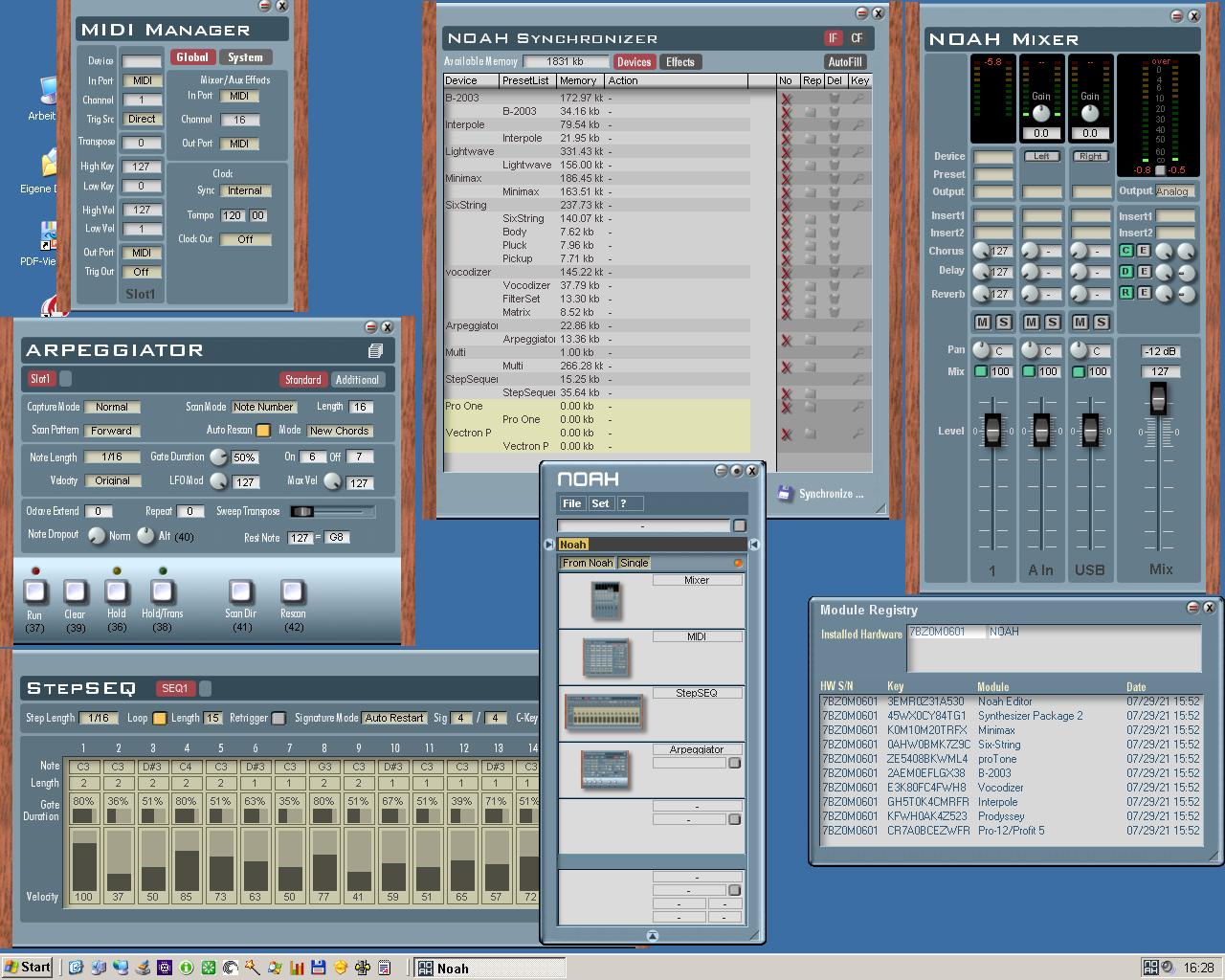

Here´s HOW TO install NOAH plugins:
1.
Create a shortcut on your desktop from this location "C:\Noah\App\Bin\PluginInstaller.exe"
2.
Drag the necessary OXE files to PluginInstaller.exe shortcut you created on the desktop
3.
You should get messages appearing from the application that you need to synchronize but it tends to take care of itself
Syncronization is IMPORTANT !
Here´s how it looks on my Acer WinXP laptop when successful:

I have the Noah v1.1 installation disc.
I uninstalled via the Uninstaller in the C:\Noah folder .
But after reinstalling the old drivers must still be there because when turning on the Noah it's not looking for any drivers .
( Driver signing disabled, in fact it always was ! )
And when I opened the Editor the same mixer setup from before I reinstalled appeared again .
So how do I actually remove the 3 Noah drivers ?
Reinstalling Windows XP is not really an option because I bought this laptop just for Noah and I don't have the Windows installation disc.
Maybe I could uninstall again then go in to the Windows System folder and manually delete the 3 drivers , would that work ?.

So, if I understand correctly, Noah Remote Editor software is uninstalled now,- right ?
Just the drivers are left over ...
Did you go into WinXP device manager,- I guess,- audio/video/ game controllers ... and had a look for the drivers ?
There should be MIDI, Wave, ASIO drivers,- and possibly in the USB section (usually the very last at the bottom of the device manager tree), there could also be an entry for Noah USB,- but I´m not sure if it´s been gone when Noah USB is disconnected.
Anyway ...
Disconnect Noah(EX) from computer,-
now search for everything Creamware Noah in device manager and right-click the driver(s).
There should be options for update, uninstall, re-install etc..
So, once found,- uninstall the drivers.
I always used CCleaner on my machines.
It wipes obsolete/outdated registry entries.
Never had an issue w/ the application.
Here´s the latest version working w/ WinXP / Vista ... https://archive.org/details/ccleaner-5.64-xp-vista
Install and clean the registry, then re-install.
BUT,- I´m now also irritated because "disable driver signing" was enabled always.
So, I don´t have any idea why your Noah rig doesn´t work as it should.
Are you really sure everything Noah hardware and what´s installed in it´s flash memory is working correctly ?
My NoahEX runs flawlessly because I started from scratch and reflashed NoahEX before I installed any software and synchronized.

I looked into my Noah WinXP laptop.
Nothing visible in add/remove software too.
No SCOPE uninstaller visible.
So, it´s all like it is on your machine, except,- everything runs fine here.
I investigated in the installed SCOPE application itself,- and when you go to Noah > application > app (I now hope that was the correct path) folder,- there´s a subfolder called "uninstaller app".
When you look into that folder,- there´s a .pro file.
But,- I dunno what to do with it ´cause I never ever uninstalled the Noah Remote Editor application from my laptop up to now.
And it seems,- EVERYTHING not being installed in the Win XP programs folder won´t be recognized in add/remove programs.
Consequently,- Noah being installed directly on C: cannot be recognized.
