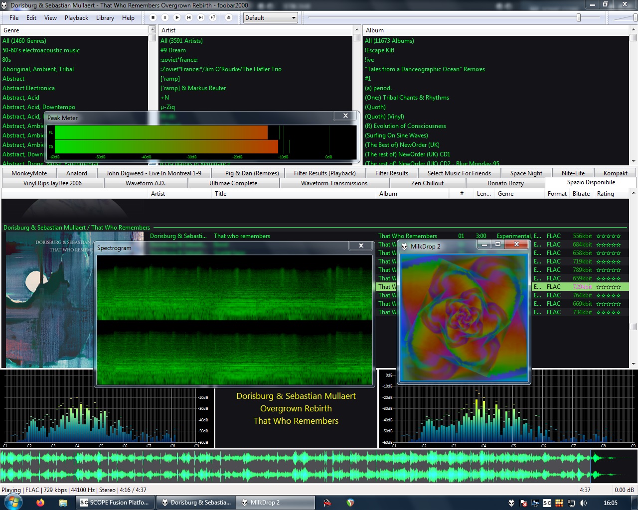

Been using Foobar here for years, using WASAPI (shared output), foo_out_wasapis component. It’s an awesome player and completely customisable but can take a bit of time getting set up the way you like it. However once done you can just copy the files over to another pc and retain the same layout. Using it in combination with the MonkeyMote app for remote control from iPhone
t_tangent
Posts: 989
Re: An audio player that works nice in Windows ?
Post by t_tangent »
On my Scope based Workbench PC
Foobar on Scope Workbench PC.jpg (467.79 KiB) Viewed 21153 times

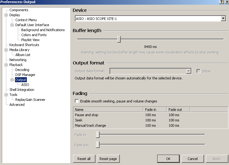

nebelfuerst
Posts: 601
Post by nebelfuerst »
Here's a screenshot of my settings.
8000ms is just the size. latency of foobar is instant.
Posts: 7746
That’s how much it stores in RAM. The hardware buffer is typically 10ms, but that might not be exposed for ASIO.
