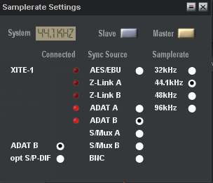

On the ADA8000, what is the master/slave switch set to? You most likely know this but didn't mention it, and from memory the unit has a switch that can be set to: Master 44.1, Master 48, Slave ADAT IN and Slave WC IN.
Can you post a screenshot of the Xite clock panel and samplerate settings as well?
Capture d'écran 2025-01-07 191541.png (17.13 KiB) Viewed 30120 times
Thanks everyone for your help.
The screenshot...
I am sure that the problem does not come from an interaction between my different devices. I selectively turned everything off to test both interfaces. I tested each interface with the other off. With the Eurorack system off etc... I still have the problem
(PS. It's not a ada800, it's an Ultragain)

Posts: 8465
Re: ADAT Clicks and noise
so you‘ve tested the UltraGain and the ES separately... keep it like that (for the moment).
Currently your clock master on Scope is Adat B (active black radio button).
Try with Adat A as master instead.
I have no details about changes over the years, but in (the very) early days Adat A was more reliable.
In theory my assumption is rubbish, but worth a try - it‘s a quick and simple change.
