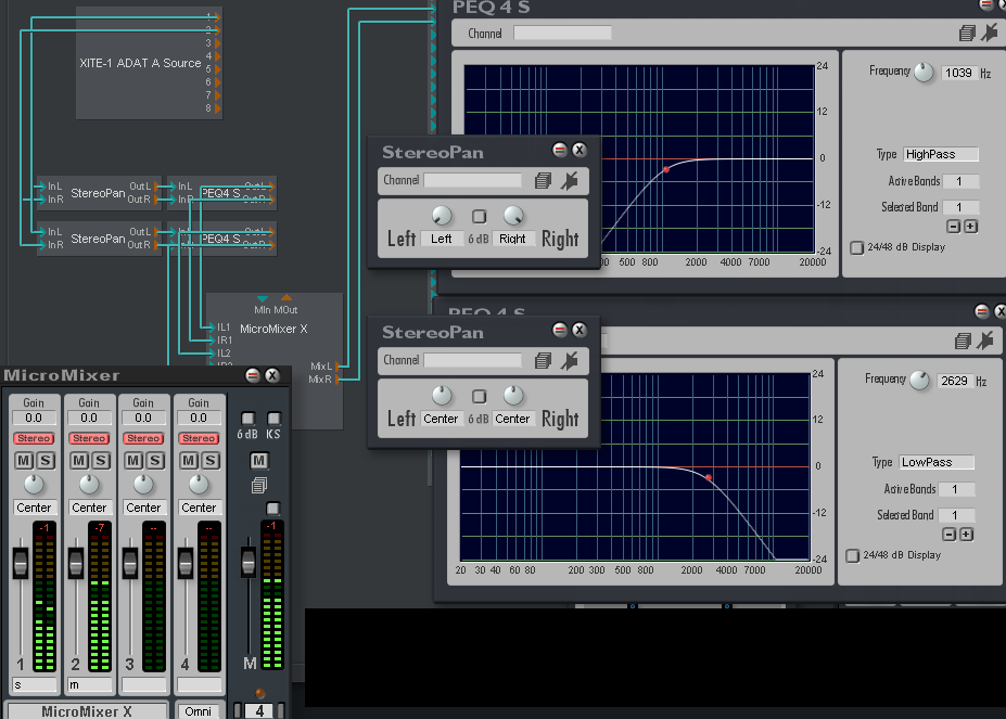

As Stereoexpander also splits the lower freqs, I tried to build my own setup.
Sounds quite similar to what I was looking for.

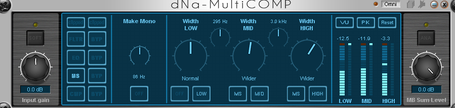

Just found out, that this function is part of dna-multicomp.
- Clipboard01.png (97.91 KiB) Viewed 22510 times
