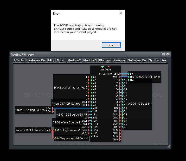

After 4-5 years, I finally changed all the capacitors on the Pulsar 2 card and installed it in the computer. Media Player works normally, but with Cubase I have an ERROR - ASIO drivers cannot be loaded.
Does anyone know what the problem is?

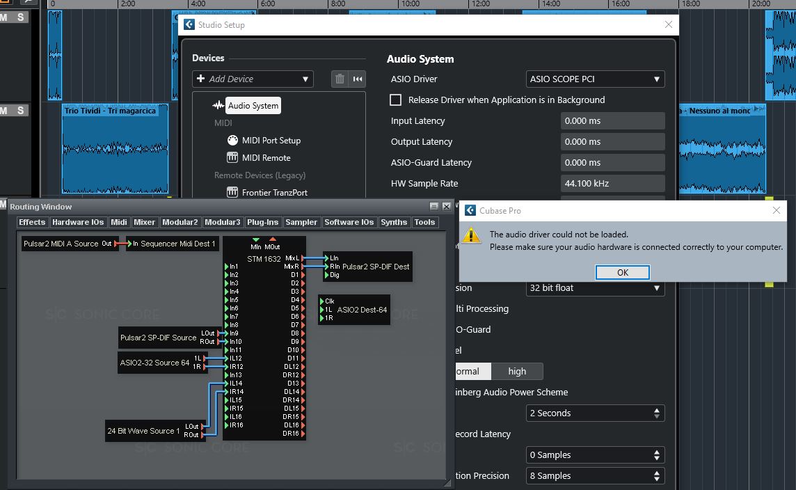

garyb wrote: Sat Jun 08, 2024 8:42 am for Cubase, i would use either an ASIO2 source or an ASIO2 flt source and an ASIO2 dest.
I tried both combinations. Here I have attached a picture of the project that worked normally for me before the capacitors on the card were changed.
It seems that there was a hardware error... The only thing I don't understand is why multimedia drivers work and ASIO doesn't.

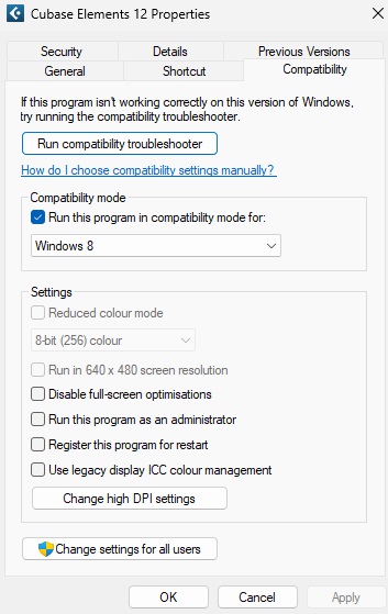

Scope platform works just nice with, I have :
Windows 10 64bit - Scope 7 - Cubase 13 Artist
Windows 11 64bit (also worked with Windows 10) - Scope 5 - Cubase Elements 12
Just remembered, since I had some problems running Cubase Elements 12-Scope 5 (ASIO was not recognized) ,try this :

fidox wrote: Sat Jul 13, 2024 10:46 am Scope platform works just nice with, I have :
Thanks! I'll try. :)

This was my original post, then at the end of post I figured out the solution for me :)
viewtopic.php?t=37359
