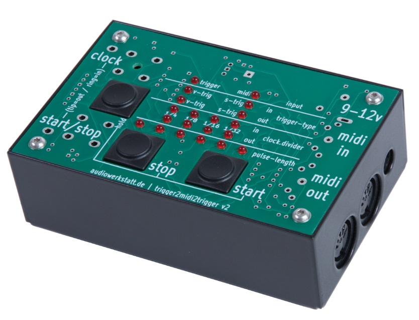

I have Korg Minilogue XD desktop synth.
I have purchased external box which "converts analog trigger-clock-signals to MIDI-clock-signals and vice versa." for syncing synth with Cubase.
When I connect Midi-out from Luna II to Midi-in's Clock box and then clock-sync out to synth's sync-in and start Cubase,
synth is "swinging" in timing a lot, there's no perfect sync at all.
I have tried different settings in Cubase (external synchronization" and it's always the same.
On synth (Korg) I can see that synth's clock is "external", so it's connected to clock-box.
Sync box setup is correctly , from provider :
1. setup cubase to be midi-master (?)
2. connect the midi-out of your computer to the midi-in of an
audiowerkstatt trigger2midi2trigger.
3. connect the analog clock-output of the trigger2midi2trigger to the
sync-input of your synth.
4. setup the audiowerkstatt trigger2midi2trigger this was:
a) input: midi
b) trigger-type-out: v-trig
c) clock-divider-out: 1/8
d) pulse-length: middle"

I manage now for this setup, that works better, disabled all Midi ports (ins - outs) in Cubase, which I don't need.
