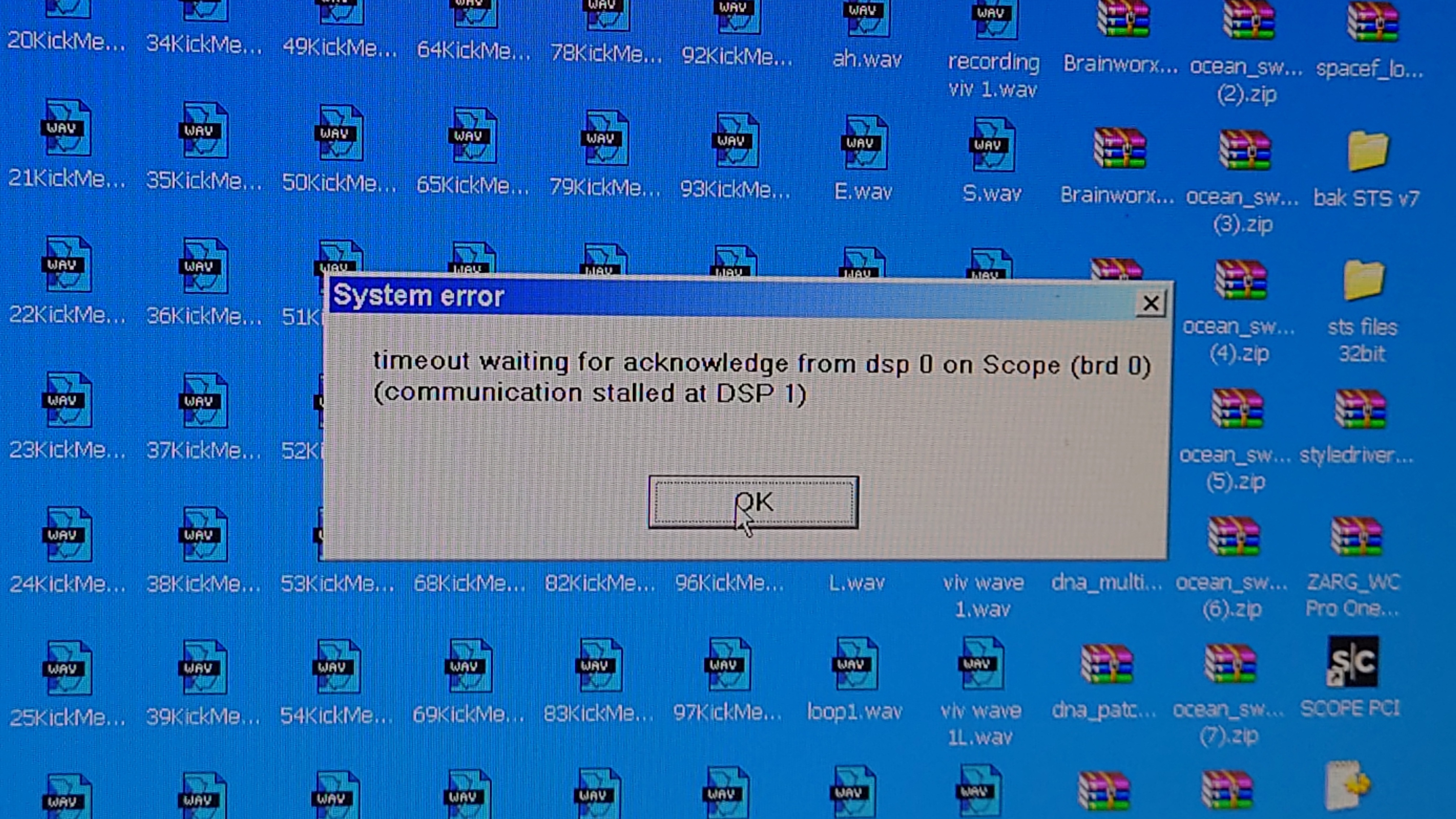

Unusual behaviour.
Unusual behaviour.
This is recent, but recurring.
Usually when communicating with another pc via adat.
Hardware or software?
Maybe time to recap my boards?
Anyone recognise this message and can relate it to a known thing.

Re: Unusual behaviour.
Yes, there’s a hardware issue of some kind developing. Solder, caps, and a few other components are typically a concern.
Such as?valis wrote: Mon Mar 04, 2024 5:01 pm Yes, there’s a hardware issue of some kind developing. Solder, caps, and a few other components are typically a concern.
The error only tells us that there's an attempt to communicate with that dsp and it failed. You have to test the board/components to find the flaw, or in most cases simply recap and check the additional (transistor I believe? or transformer) at the bottom of most of the cards to ensure it's still in good shape. I've done 4 cards so far, and only one continued to fail after repair indicating it was a deeper issue with one of the DSPs.
My personal opinion, is that even though our cards are manufactured to correct specifications for the tolerances these chips require, we've had them in service for many many years. The chips get HOT, which they are designed to do, but after a few decades the other components on the card begin to show wear and tear, and power cycling a system (warm/cool cycles) as well as the resulting voltage spikes that PSU's cause can eventually impact an aging PCB board and its components. Ie, solder can crack and break, chips do take a minor amount of damage under normal operation (gates operating actually triggers a change in the silicon to open/close the gate), and aging capacitors may fail to properly buffer voltage when they start failing, etc.
So I have always sought to have my cards well cooled. The original P4 era Xeon system I had was HOT HOT and all of those cards eventually failed. My newer system never breaks a sweat, and using thermal probes I can see the temperature (and airflow) around the cards themselves are much much better, which gives me hope that they will function for years to come. Given that my old cards were all ~20 years old and were in constant operation for their lifetime, I can hardly complain. I just care that the system continues to function.
In some rare cases, the pci slot on the mainboard might be the cause.
I had a card with 14 DSP, which I recapped, changed the regulator and still got dsp errors. It was a failing pci slot, in which some other cards still worked. I wasn't able to evaluate, whether it was a power issue or some dma stuff.
The DSP chips themselves are built to withstand the heat, they are used in cars and industrial applications.
PCI boards lasting 20 years is approaching limits with heat, same with mainboards and system components, which is why I tend to invest in workstations & server boards where appropriate.
