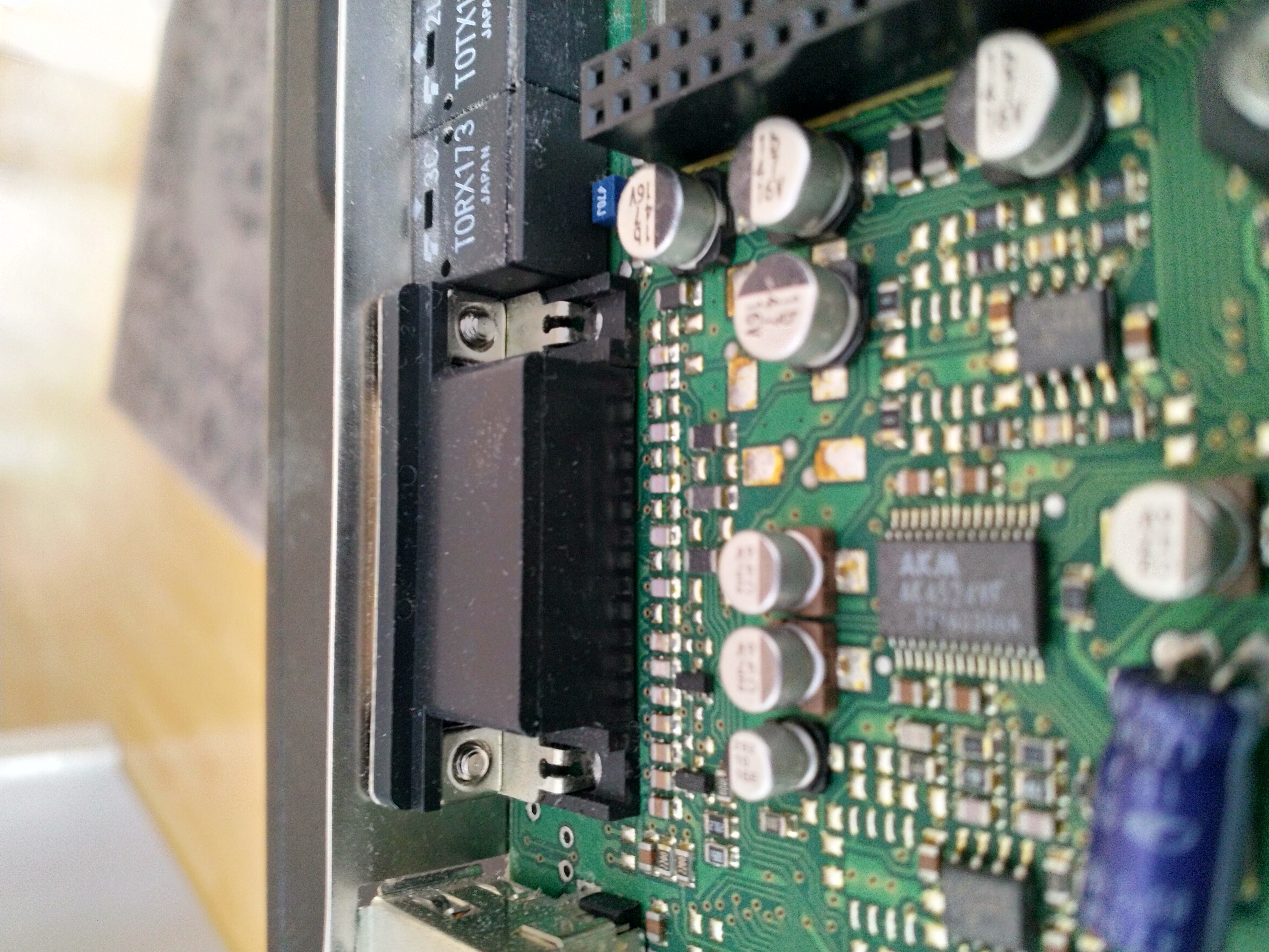

Hi,Unfortunately I can't find on the Pulsar interface board or interfaces
anything that would help solve the problem for me with reference to your answer. As an attachment I put a picture of the card (See Appendix Pulsar card.jpg)?
Pulsar card.jpg (7.58 MiB) Viewed 15201 times
Re: Right Output Channel not working
the d-sub on the cable whip as well as the connectors on the cable whip?
