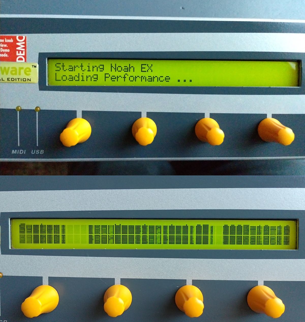

Hi Folks ,
Wondering if anyone can help please.
I just purchased a NoahEX
It powers up ok ...but then 2 seconds later the LCD screen gets scrambled . I can sort of see the menus ..froma low view angle .
But ...Demo mode not working , so I assume there's no sound.
Seems I have bought a lemon , not happy :(
Creamware installation disc came with the unit but I need to get WindowsXP to reinstall firmware...which can be quick risky apparently.
I bought this to have a standalone unit that simply works ,not to run around going down rabbit holes .
Is there a button press combination I could try , factory reset type thing ?
Before and after screenshot attached , power on at top ...2 seconds later at bottom .
Thank you , Michael

Posts: 2942
Re: NOAH Screen scrambled
MrV wrote: Fri Jan 26, 2024 5:35 pm
I fear you´d have to !
Once you got your Win XP laptop, install the latest Noah remote Editor (v1.1) and try to read out your keyfile.
Save it when that worked.
Also try to find out if the latest OS is already installed.
Now grab all the files S|C might be willing to provide and reflash the machine.
This all only works when there´s just only a display failure.
It might be software of hardware issue, possibly RAM the display uses.
Also double check the PSU.
MrV wrote: Fri Jan 26, 2024 5:35 pm Is there a button press combination I could try , factory reset type thing ?
IMO, the only true factory reset is reflashing the machine w/ the latest image files available.

Posts: 2942
MrV wrote: Tue Jan 30, 2024 5:40 am Thanks Budweiser.
Someone mentioned that their Noah has the same display problem but the Noah works fine anyway via the remote editor.
Yes,- and YOU bought it to use it standalone,- like me.
In fact, I´m already pi##ed I have to use the editor for "Prophet5" all the time ´cause this damn installation file on S|C ftp server is the latest available and buggy.
In opposite to all the other devices installed, it doesn´t provide full editing from Noah front panel and curser jumps back to program number in display when the related rotary/button to enter "in depth" synth parameters is pressed.
The Noah is so cool to have as a standalone synth module and I play much more keys than record, mix and master music.
MrV wrote: Tue Jan 30, 2024 5:40 am What I'm concerned about is the fact that the display works fine during power-up and loading the system ...but then it's scrambled.
And also no audio in the Demo play mode , hmmm
Not a good sign methinks
All guesses,- it´s hard to say when not having the toy on the bench.
Your display seems to work, gets power.
But you´re unable to read it a.t.m..
Maybe some component driving the display fails a few seconds after the unit is powered up,- who knows?
Demomode:
Because you cannot read anything, you don´t know in which state the machine is.
There´s a difference how demo mode works in MULTI- or SINGLE mode.
In SINGLE-mode, the currecntly selected preset will be demoed,- so that should work WHEN a preset IS selected, the output volume is set correctly and the main output is set to analog.
BUT,- currently, the unit might wait for you selecting a device 1st before you´re able to select a preset using the push-button rotary encoder.
Can also be it´s currently set to digital (SPDIF or ADAT) ... perhaps.
In MULTI-mode, you´d have to select the preset (in one of the 4 slots) using the cursor.
Without the display, there´s no cursor.
And,- in MULTI- mode, all the outputs can be used individually for each device/slot.
Can also be your display is intact and the Noah OS (in flash memory) is corrupted,- and aged flash modules can also fail.
Do you have a friend/tech being able to repair MIDI modules ?
The displays from that time aren´t much different.
To me it looks like the one used in KORG M1 or Roland D50/550 or such (2 rows and these dimensions).
With luck, it´s njust only a display failure,- inverter or such part.
Posts: 2942
https://www.amazona.de/green-box-creamw ... yntesizer/
when looking at that (enlargable) pic, there are a bunch of ribbon cables inside,- at least 1 of these going to the front panel.
I´d open the machine and try to clean contacts w/ DeOxid or such and reseat ribbon cables.
And think about there are 2 sockets,- one @mainboard and the other @display hidden by the frontpanel back cover.
Replacing the cable for a test makes sense too.
:wink:

Well I opened the unit .
No evidence of any loose ribbon cables .
And the screen is still scrambled, meaning it's effectively a dead unit for me since I need to see those buttons for software setup . Grrrr
I wish I could find any of the original Creamware guys who might be able to give some clue about this ...but it's all such a long time ago now . Oh well :(
Posts: 7778
Check the capacitors and other components, look for signs of bad solder connections or swollen caps.

Posts: 2942
MrV wrote: Thu Feb 01, 2024 12:53 pm Thanks Gary and Budweiser will look at those .
There's obviously some software problem causing the scrambled display because it works fine up until loading the system...so it's obviously not a loose ribbon cable etc inside...
Do you have a chance to check the PSU ?
Maybe some voltage the display needs in stable condition drops shortly after powering up the machine.
These aren´t standard ATX PSUs,- I guess it´s what was used for computers in Intel P3 times.
OTOH, I recognize only the font/character set isn´t visible in both rows of the display,- so can be you really need a new display.
Have a look if these´s something printed on the back or elsewhere on the display and google for it.
These days, there´s a good chance to find a replacement @ebay since there are small companies offering all kind of LED and OLED displays for old gear,- samplers, other MIDI modules, keyboards etc..

Post by MrV »
Thnx Budweiser....well possibly.
What worries me is that the display is working perfectly at power up ..and Loading system ....buta few seconds later it then it becomes scrambled and unreadable.
So the LCD is actually fine.
It's either some sort of sudden voltage drop ..( but the display doesn't get dimmer )
Or
It's a software issue ....I tend to believe it's this but that's just a guess.
