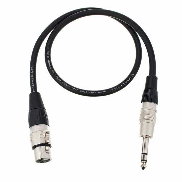

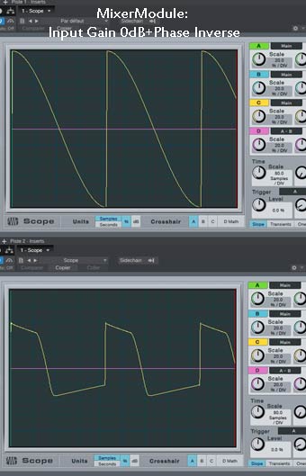

Hello,
I am reamping stuff to send to analog distortion pedals (because I tried a lot of stuff, convolution etc, and digital/analog drive definitely does not sound the same to my ears).
There is a thread here, about reamping with an A16 but did not find the same for xite, so I thought it could help someone.
With the A16, I do not know if balanced jacks will work, but with Xite, you can do the following. it is known tricks, but now it is tested on Xite.
With Xite, you need to use symetrical cables: XLR to 'stereo" jack (ie, balanced) , from the analog outputs to your pedal rig.
Then I use a mix device before the outputs to lower the level down to -20 dB or less.
That way the signal is as clean as can be, and I wonder what a Reamp box could bring more.... sound coloration ?
I am doing without a reamp box = money saved.

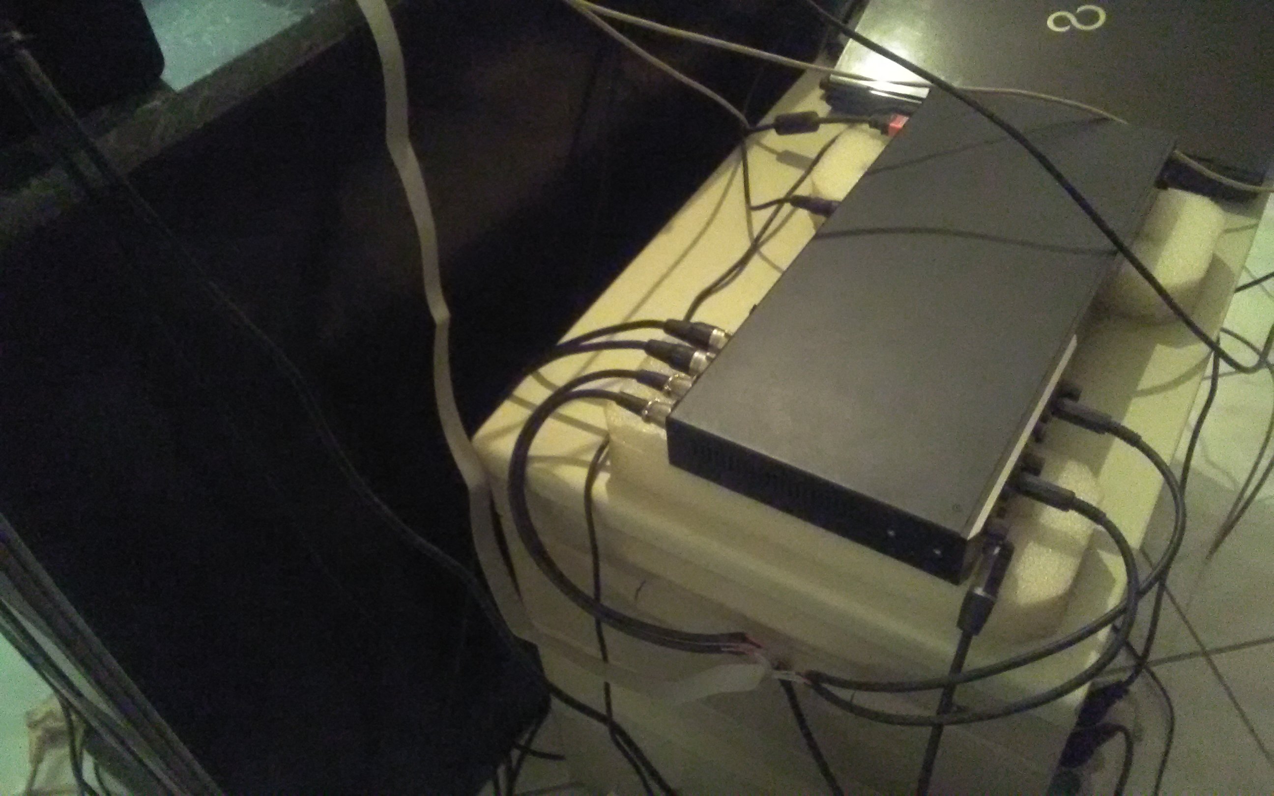

Pic of the cables needed attached, and of my SDK connections.
Anyone interested in a regular Scope device for the levels ? (like, two levels, no mix, just to set levels "pre-analog dest") ?
let me know if you need that.

- reamplevels.jpg (6.47 KiB) Viewed 22661 times
- symXlr.jpg (17.85 KiB) Viewed 22661 times

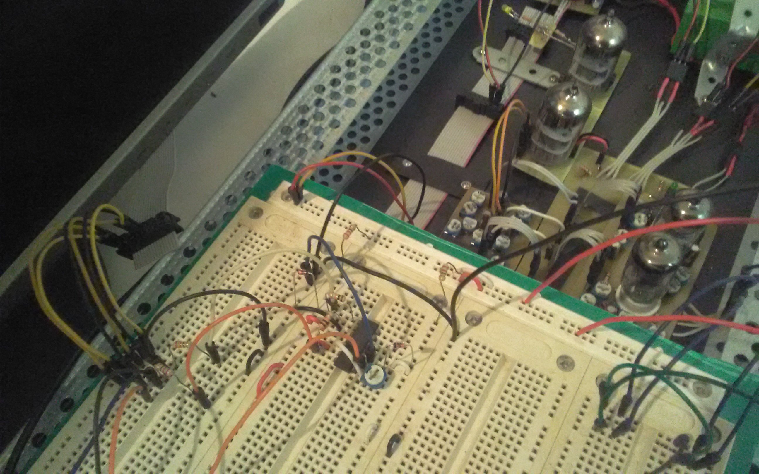

I am a guitar player. I am not sure about the case. With my metal zone pedal i have used the phono out from xite and the mic inputs to return the signal. I do not have the a16.
Currently I had made a balanced driver for the xlr inputs which takes advantage of the whole signal so to keep noise levels down when processing stuff with my analog custom fxs. It works fine. so i do not attenuate anything because i lose signal If i do.

Re: Reamp with Xite (solutions)
yes i have the phones output volume at half i think it is -6dB in this setting.
My analog stage has a +-15V split power supply and I have tested the setup with sine waves so to have good signal. Perhaps I attenuate a bit in the analog domain and then boost my digital return signal by 6dB. I get clean signals with very low noise floor and limited hum. But my tube amp is custom made and i use trimmers to get different amounts of distorted or clean signals.
Ofcourse i use the volume of the sound modules to find the sweet spots because every sound has its own needs. In general testing with sine waves and aiming for strong undistorted signal with low noise floor should lead to satisfactory results. When using the balanced audio inputs i get 0dB sine waves with a 6dB boost on the digital domain and noise floor at -96dB. It is perfect for me and for professional work

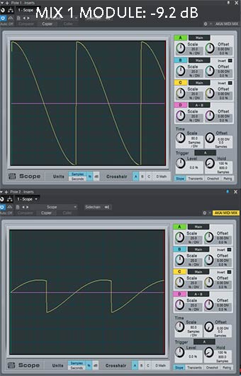

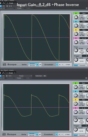

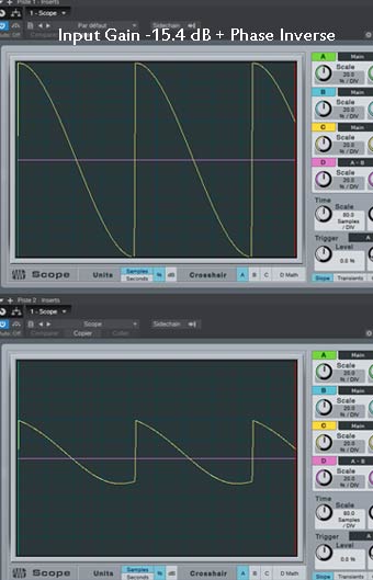

Hello !!
yes, I too think that, with attenuation in xite, you may loose "amplitude" of the audio, but not bit resolution (it is still 32 bit, not bit crushed )
So anyway, I did a recording, not to proove my point agressively, but to better understand.
It's a track I am working on with my harmonica (
The reamped soundis the steel / slide guitar
Can you really tell which is the original signal and which is the reamped one?
>>>> https://soundcloud.com/user-442800355/reampxlr-slideguitarsample
Wave 44/32 here: https://spacef-devices.com/File-downloa ... deGuit.wav
Slide Guitare: every 2 loops change the destination (to daw master, or to analog dest/guitar pedal).
The slide guitar is a sample from a library, not a personal recording (but does that change anything ?).
I will tell which is which but just to do a blind test, it's better not to say.
You may tell because the master has Ozone on it, but when it is sent to Analog Dest, the slide guitar is played in parallel to the mix.
The output volume is -9.2 but that's meaningless because there an input gain on the pedal (they play together, settings may vary according to sound/mix etc).
Circuit is analog Dest->XLR/TRS->pedalon but wet Off (only dry passes through)--> pedal out to Mooer Radar Bypassed --> to HiZinput-->to xite mixer.
So I am not here to revolutionize impedance, but for a guy like me, the technic sounds good enough to experiment with guitar pedal and record it.
No?

Apparently, I have nothing to do on a 1st of Jan 2024, but to geek out
Happy new year everyone !
These are oscillators tests, with the mutli-oscillator of Scope on "Saw Down" (to see transients)
First image is the oscillator direct to asio, no level attenuation.
Second image is the shape when it is back to daw (though analog dests and Xite 1 xlr input+HiZ+Pad (which is very loud compared to a simple mono guitar jack = may cause additional drive). So may be I can improve something by using different jack type.
1 / my setup explained above (simple mix module, at a level that does not overdrive/clip/saturate, which depends on the sounds peak)
2/ gain @ 0dB + phase invert using an old "Mixer Input" module from scope SDK: it is not a "mix" (level) module but a gain+phase button (so, different math than the "mix" module)
3/ gain at -9.2 dB (like with the mix module) + phase invert
4/ gain at -15.4 dB + phase invert (best match: so if you use a gain module, the level is set differently than on a simple mix module, otherwise there is stauration/waveshaping).
Results are similar with other osc shapes.
Personal Conclusions:
By listening, the sound difference is not obvious at all (to me). it sounds more or less the same with saturation if levels are not set correctly through the whole chain (analog dest, pedal input, scope input = lots of occasion to break the wave shapes).
The shape change according to levels, and it is not the same amplitude. This could probably be solved after normalizing/gain the final recording in the daw. But pedals and external effect will play with less dynamics/amplitude.
I do not have a reamp box to compare, but I would conclude that if you use the workaround method (no reamp box ), the result will depend on the modules used before the analog dest, and that it could be better to invert phase in the daw, on the final recording.
That's something I would have preferred not to know because my results are fine enough in a mix, but now I see what a reamp box must do, and how levels change radically the shapes. I will probably have to get a reamp box sooner or later to see if it really works (no hurry though, must see if I still have fun with my pedals in a few weeks). At least I know what to test now
