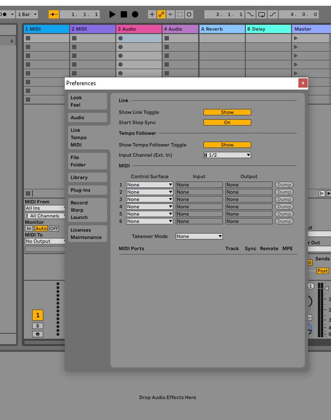

Surely you know how to enable midi within Ableton, can you post a screenshot of the midi/controller page just in case?

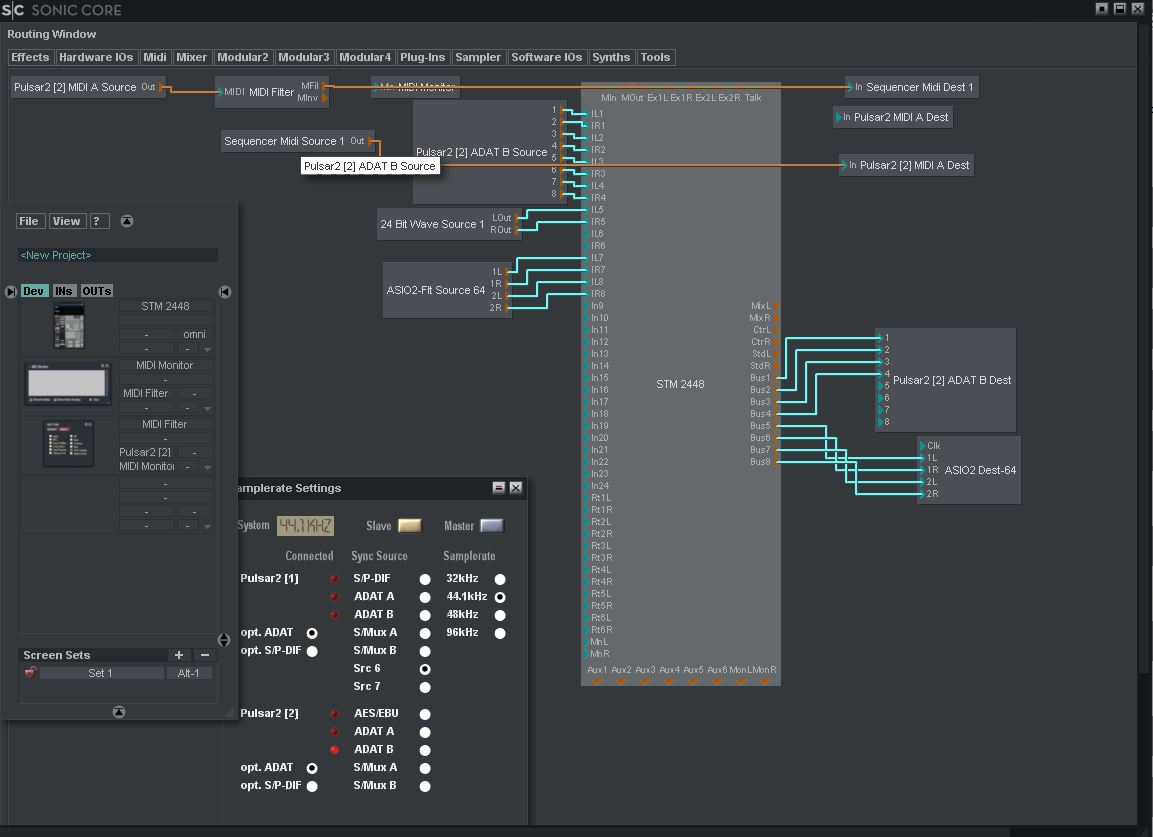

Project Window.JPG (96.75 KiB) Viewed 8464 times
