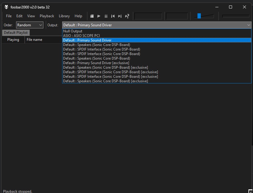

You could also use foobar2000 with the asio-plugin. This way you could check if feeding into scope works.
