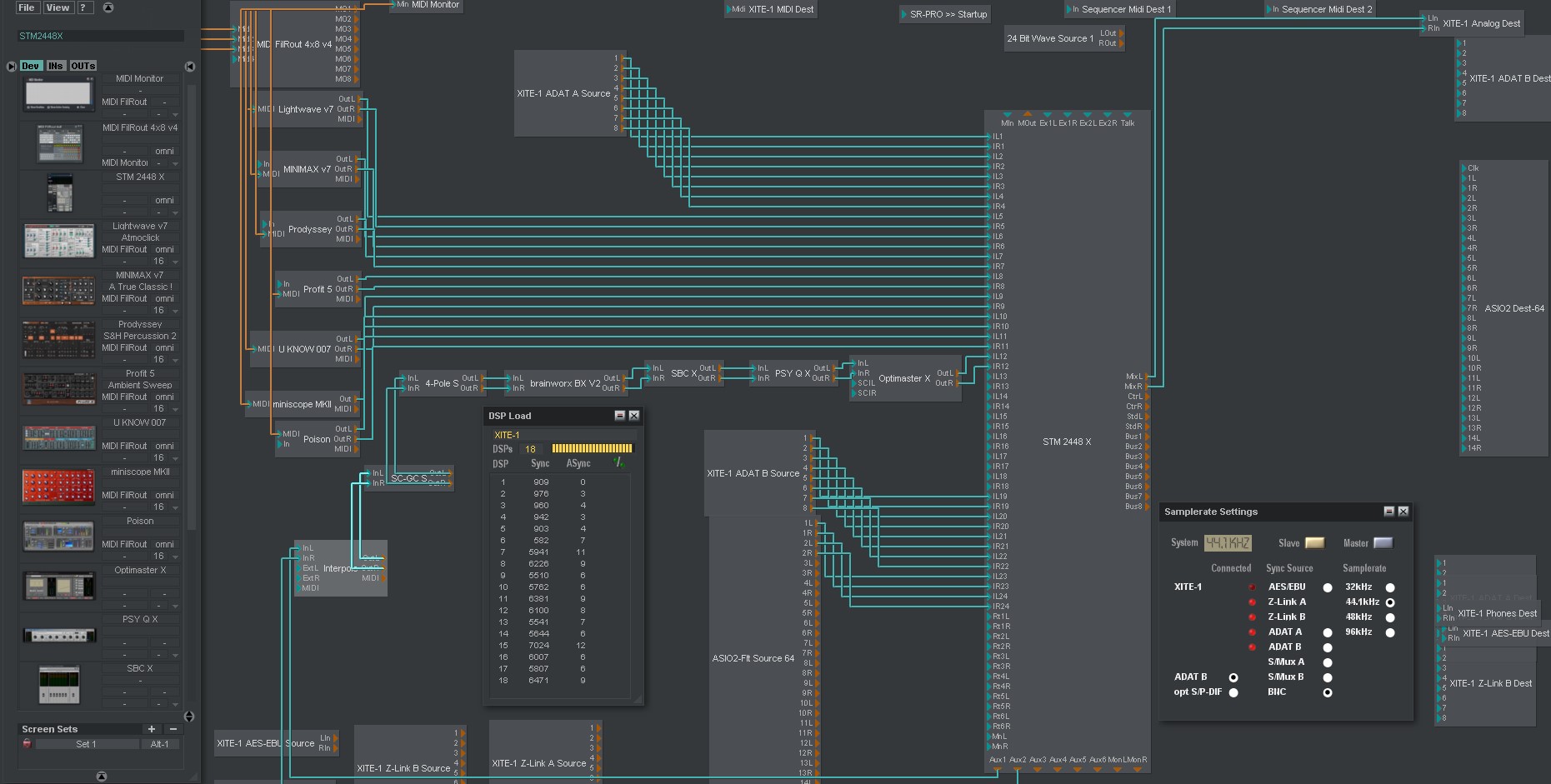

My projects tend to be big ones, so I sometimes face a dsp routing error on my xite.
This can be solved by assigning some devices to a certain dsp.
I assigned z-link ins and outs with a patchpannel to use DSP7 and it worked for hours.
After reloading the saved project, there is no sound. I have to delete the z-link dest and bring it back into the project.
Clearing the dsp assignment didn't help, I had to remove and add again.
Bug ? Workarounds ? User-error ?

Is there any trick how to keep scope7 from running dump reallocation algo on load ?
The need for manual assignment occured when using the channel element within a larger project. (30% load of xite)
Obviously the auto allocation failed, thus I got an "cannot route..dsp to dsp" error, which was easily resolved by allocating to the recommended new dsps for IO-tasks.
After reload, the forced allocation is still shown at the dsp-menu, but the internal routing seems to be disfunctional.
Using larger devices instead of many small ones, seems to avoid the dsp errors.

So here comes the "howto repeat":
Using noise from controlroom goes through mixer, is then spread to a bunch of channel-elements.
Channel element connected to Z-link1-78 is connected to speakers.
Everythink works.
Now I assign the (shifted) channel-element to dsp7, the sound disappears.
Now I assign the (shifted) channel-element to dsp8, the sound comes back.
Now I assign the (shifted) channel-element to dsp7 again, the sound stays.
I save the project.
I load the saved project and no sound audible. The meter of the allocated channel shows no input signal. (see attached picture) No DSP-assignment is visible in the dsp-menu.
I can get the sound back by allocating to some dsp.. (tried 6, 7.. worked)
I attached the projects before and after assignment to dsp7..
Everythink works.
I save the project.

Re: no sound after dsp assignment ?
where are the z-link loaded? are they assigned to a specific dsp?
delete all unnecesseary modules.
assign the z-links modules to a specific dsp untl it works. i.e. the z-link modules should have a dsp that is used by these. find it by changing the assigned dsp. if you get output you found the dsp.
assign the channels to this dsp or find the dsp that has the most connections to it and use this.
if the z-zlinks are situated in a dsp that can be accessed only with communication channels (no direct connections like the asio) you need a system with better pci bandwidth
in the sdk you can see which dsp some modules are using by looking in a folded module. Ask someone with the sdk to inform which dsp the z-link mocules are using
nebelfuerst; Thanks for the screenshot and project files.
So after testing both project files I did not have any issues with the sound. Placed all devices on DSP 7 (except the STM mixer) and it still worked fine. Moved a bunch of other devices in the project to different DSPs and did not lose any sound.
Not sure if you know this but the STM2448X, STM 48 S X, and STM 4896 X appear to be locked to DSP10.
I would recommend you build your project from scratch and test it again for the same performance.

B.t.w.,- I wasn´t able rebuilding Yayajohn´s XITE-1 project where he maxed out polyphony up to 16 voices for every SCOPE stock synth.
In fact, I gave up after some time and accepted it doesn´t work w/ my XITE-1 which is using the older PCIe card (w/ DVI connector) in my 19" 4U rackmount DAW PC (Z97, Intel i7 4790K, 32BG RAM, SSDs, Win7 Pro SP1, SCOPE v7 x64).
With my system, I get SAT connection error messages soon and when I load about 4 or 5 synths and try to max out polyphony to 16 voices for each.
I made a PDF from his post and put it in the attachment,- just as a reminder what we´re talkin´ about.
Below a pic of his project.
