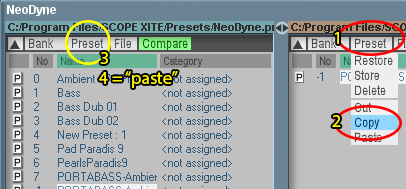

unzip then Import the preset list in the secondary preset window, then copy/paste the preset in the main preset list window, or load the preset and resave it where you want.
