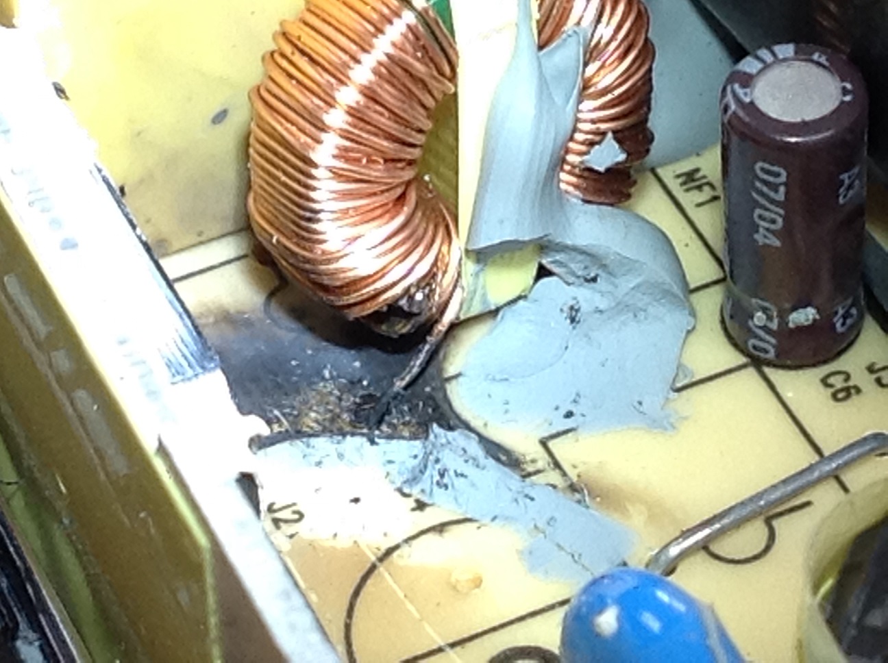

It was actually the inductor coil that blew. I just ordered a replacement adapter from SC so decided to open up the original one and see what happened, and the inductor coil has burnt through several copper strands. All the caps look ok although I havent tested them or anything else. Anyway, just thought it would be of interest. :)
HiPro Power Adapter.jpg (297.01 KiB) Viewed 23657 times
HiPro Power Adapter Burned out Inductor Coil.jpg (282.75 KiB) Viewed 23657 times
Posts: 7763
Re: XITE-1 power adapter replacement
Thanks! (Caps have issues when idle was referencing a 2nd PSU stored for years in the event I would need one). Looks like a defect that took time, or a transient, to fail.
Posts: 8467
Yes, the coil blew up, but that’s most likely the symptom, NOT the cause... ;)
t_tangent
Posts: 989
Post by t_tangent »
True, it was likely something else that caused it. I might check the caps and some other components just out of interest when I have time. But more importantly a new adapter is on its way from SC. :)
