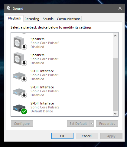

1) Unfortunately. Ive noticed that in Sound Devices there are 3 sets of Sonic Core speakers and spdif Interfaces, doesnt seem right, should i uninstall the lot and re-install V7?

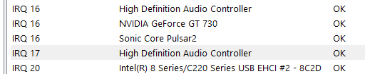

Shared IRQ's.png (3.71 KiB) Viewed 3607 times
Sound Devices.png (34.82 KiB) Viewed 3607 times

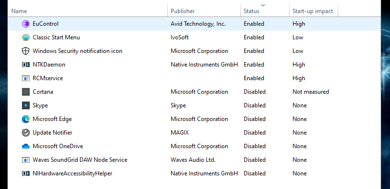

Audio devices.png (5.31 KiB) Viewed 3607 times

I have no Win10 experience, but in previous OS versions it was‘t cool if Scope shared with the graph card IRQ.
Try to move Scope to the other PCI slot and check if things improve.

Thanks Gary, are there anything in those pics that give any clue to the odd crackles and pops that have started again?
Re: Scope card and surround/atmos in cubendo
if you could move the card to another slot, it might help. as astro suggested, sharing an irq with the graphics isn't best. is EIST, hyperthreading and/or turbo disabled in the bios?
