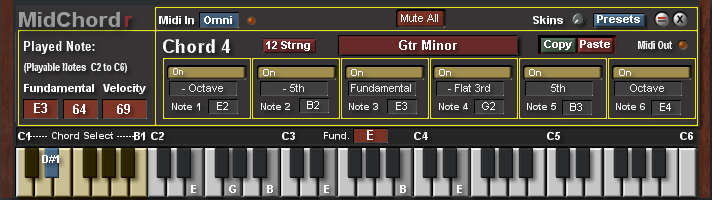

Hi There,
A new toy to play with.
Its a one note chorder that allows you to setup 12 switchable chords per preset.
If you are like me and do not pocess great keyboard skills this device may be what you are looking for.
I started out to develop a chorder so I could setup guitar like chords, but soon realised it had wider uses.
I have included a short PDF to detail the functionality.
I hope you find it useful.
regards
maus
MidChordr.zip
(1.88 MiB) Downloaded 427 times

There is a couple of things I would like to do but haven't figured how to
- Delay the midi to various notes so we could get a kind of strumming effect; and
- Adjust the velocity of individual notes. This would mean extracting the velocity data from the incoming midi note and then reestablishing the midi data for delivery to each note. Not sure this can be done.
maus
