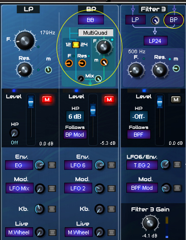

Filters:
Filters need one input for audio to be filtered, so they can only have 1 modulator input. As modulators are mixed "pre-insert-inputs" , the single modulation input has no consequence on the complexity of the filter modulations.
In Neodyne, you can use insert filters in Filter 2 (BP) only. It will be used in parallel to the original BP filter. You access the insert slot using the BP menu, by selecting "BB". It uses the same modulator mix as the BP filter. You can shape this filter further by selecting "BP" as a source of Filter 3.
On the picture below, Both LP and BP are "pre" filter 3, becauyse they are muted from the filter mix. if you unmute them, they will be parralel to filter 3, and chained at the same time (as they are the sources of Filter 3).

Filters:
- filters.jpg (123.97 KiB) Viewed 14241 times

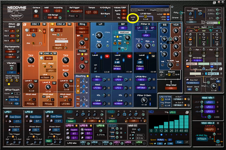

MCC
Click on the MCC button to show small potis that you can assign to Midi CC , allowing to remotely select most menus. In general, the menus are for modulators but some of them have other functions. The potis are placed "where there is room", but it should not be difficult to know what they do just by looking which is the closest menu. There are a couple of menus that do not have such potis (mod outputs and sequencer triggers for example).
I suppose that the most courageous users could use this function to change modulators without using presets, by programming the changes in a DAW. it can also be used to change modulators manually using the potis, eventhough this is generally less convenient than using menus. A useful function to remote control would be the HP type of Filter 2 and 3, or the Ring source (probably the best use for MCC) , or the Filter 3 sources . Anyway, the feature is there if you need it.
Once the potis that you need are assigned, you can simply hide them by pressing the MCC button again.
- anim-MCC.gif (648.27 KiB) Viewed 14212 times

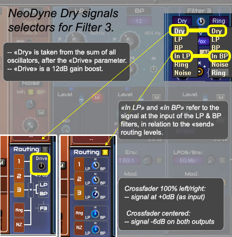

Here is some more info about the available "dry" sources for Filter 3.
- "Dry" is the signal from the "sum" routing.
- "In LP / In BP" mean "Input of LP/BP" and refers to the signal sent to LP and BP with the "send" routing.
- Noise and Ring are also dry or unfiltered signals.
-"LP/BP" refer to the outputs of the LP and BP filters. These are not "dry" signal, because they are filtered.
All routings are available all the time as sources for Filter 3, even if they are not the currently active routing.
- The "Drive" of the "dry routing" allows clipping the oscillators mix. the "dry routing" could have been called "classic routing" because it is similar to the mixer of classic synths. Putting the drive to zero allows softer sound, while putting it to the max produces more aggressive sounds. Also remember that for both routings, the volume is first set with each oscillator "level" poti. Do not hesitate to go to low levels at the oscillator stage, for the best balance and softness, and then boost at the poly/comp/output stages.
When LP or BP are selected, a +6dB gain becomes available. It acts on both LP and BP input levels of Filter 3. It is not more than +6dB because it is already loud and likely to clip, especially when Resonance is used on the LP or BP filters. The 6dB gain is common to LP and BP, but you can adjust the balance of both sources with the Filter 3 "source crossfader". if the 6dB gain clips, just set it to the minimum position, then boost the sound with the "Filter 3 Gain" potentiometer located at the bottom of Filter 3.
- ManualNeodyne-Dry.jpg (71.84 KiB) Viewed 13574 times

"Midi CC" is not a macro but a modulator that can be sent to most destinations, allowing control of several parameters with 1 potentiometer. Midi CC was initially made to use Midi CC modulations recorded in a DAW, but it can be used manually with the mouse or midi hardware.
The "Lag" control, smoothes out midi stepping (if desired). Long Lag values can be used to make a hardware button generate an ASR envelope (Sustain = while the button is On).
The screenshot below shows the basic operations with Filters. Midi CC can also be mixed in Mod Mix 1 & 2 and could also be used for Pitch control (less easy but appropriate for drums, percussive or glitch sounds that do not need to be in perfect tune).
- Midi-CC2.jpg (91.17 KiB) Viewed 13506 times
