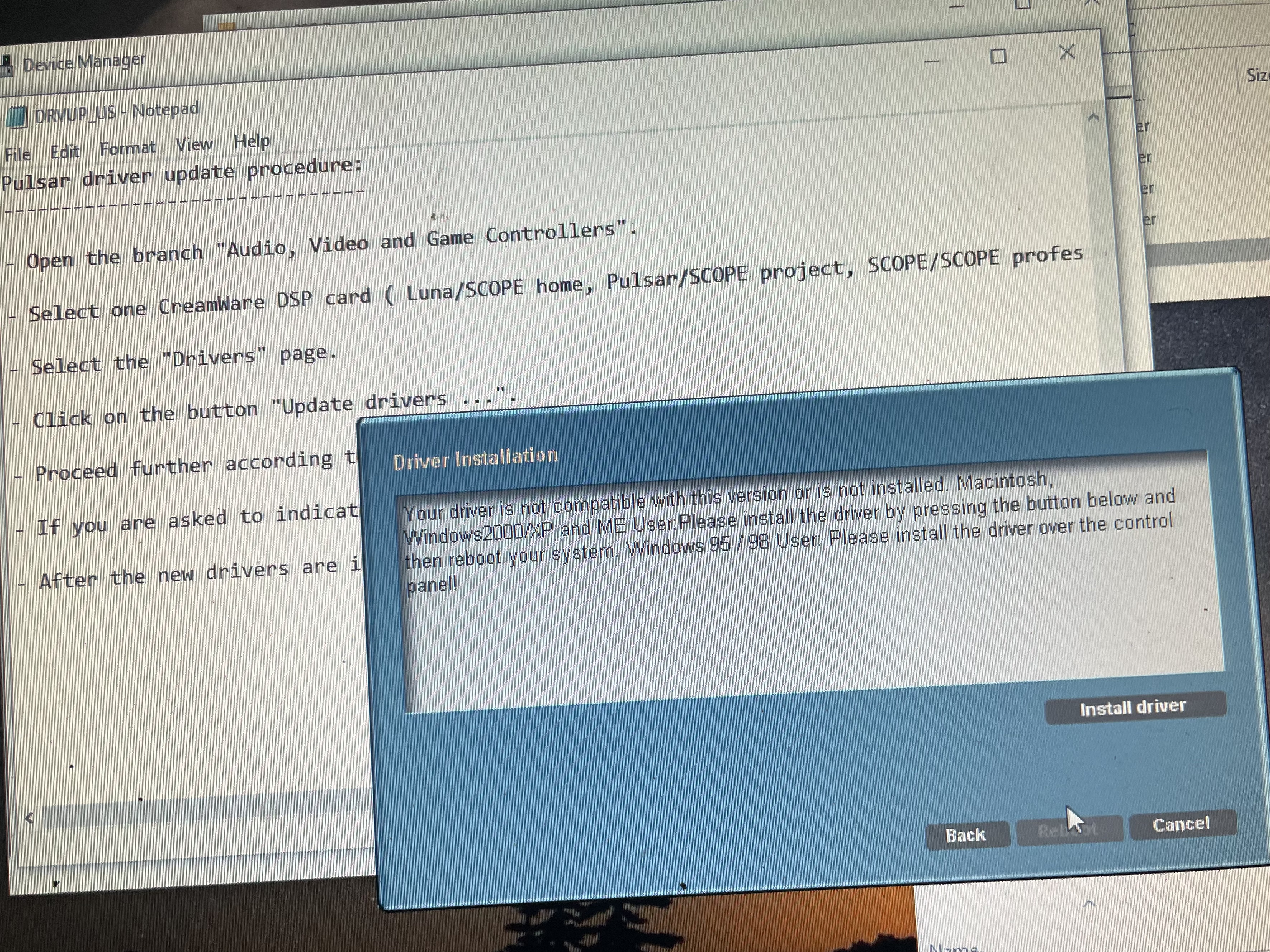

Trying to install Scope 4.0 on windows 10 32 bit!
I installed the driver manually as was directed by the installer rebooted and can see the card is installed without issues, but after trying the installer again it is not recognizing the card being installed. Even activated the bcdedit function.
Any pointers?

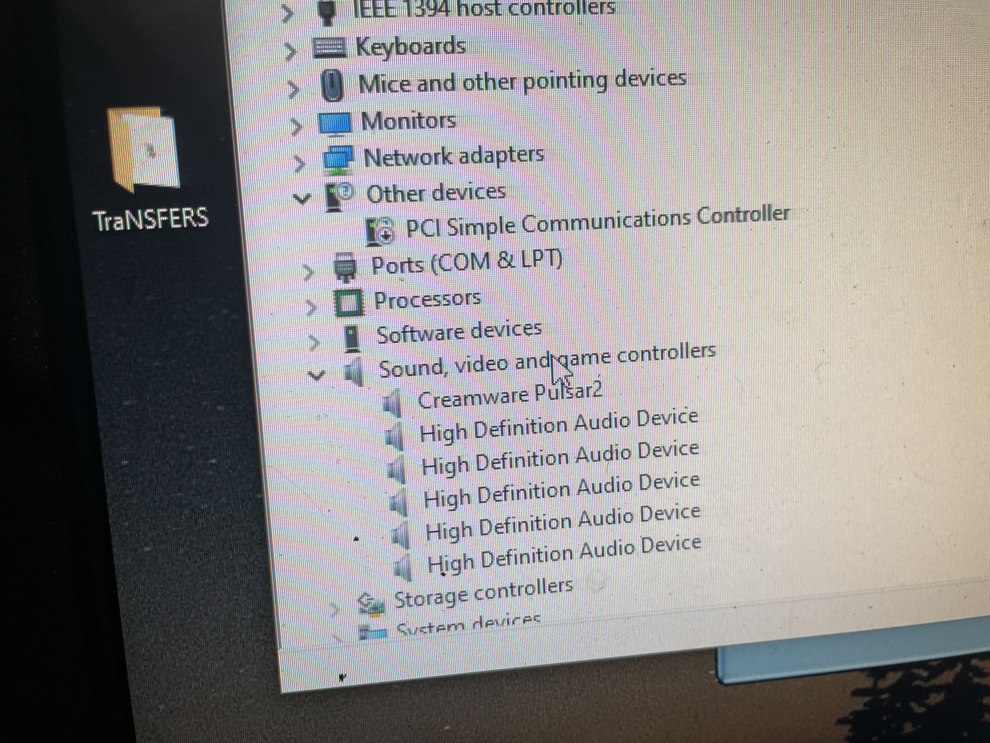

Driver wouldn't be related to seeing the card, it just would show up as an unknown device if it's not recognizing it. Do you see that?

The card shows in the device manager as working correctly. I just can’t get the scope software to install, it’s stuck at install driver and only prompts the text file for doing the manual driver.
Thought there was a way to bypass the check.
YISH313z
Posts: 328
Joined: Thu Dec 29, 2011 7:12 pm
Re: Don’t laugh! Scope 4 and windows 10. 32 bit issues
Post by YISH313z »
See attached
