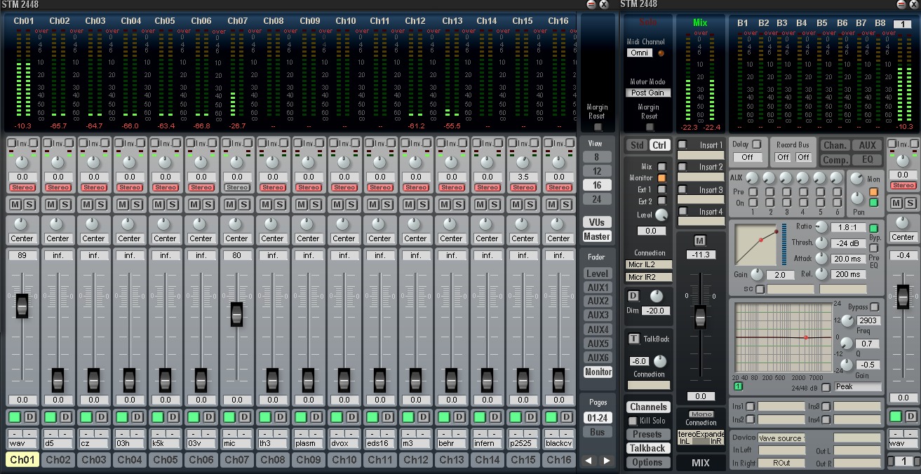

I'm facing a simple problem, which I cannot solve for 2 hours now:
I try to get Ch01 on CTRL-Output.
Setting to mix gives full output, but setting to monitor give just silence.
What is missing ?
What is missing ?
- Clipboard02.jpg (319.33 KiB) Viewed 6393 times

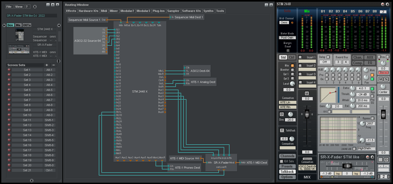

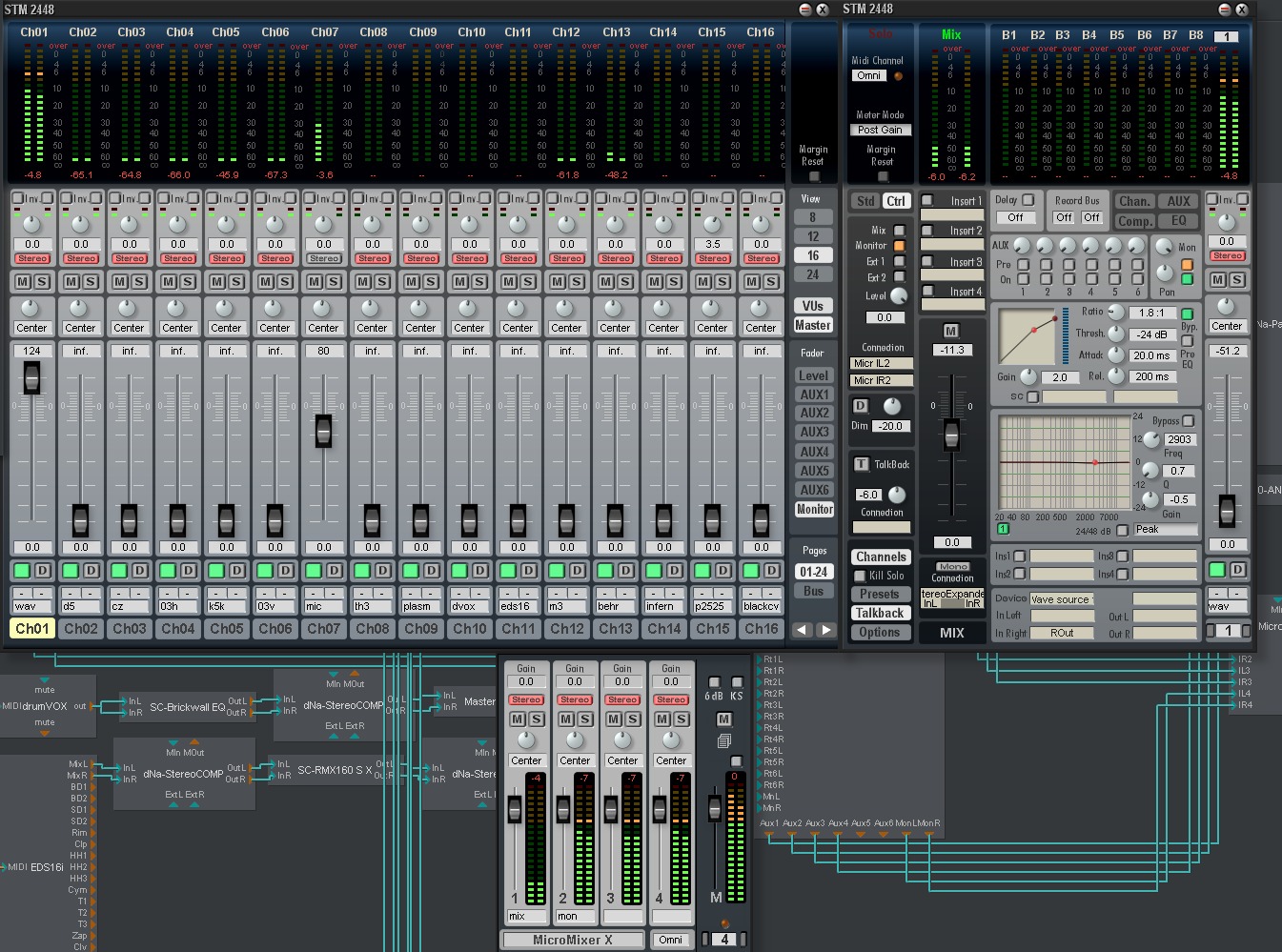

Here are some more pics.
I use VU-meters of micromixer to check for output signals.
Selecting "mix" gives signal, but selecting monitor just silence.
- Clipboard02.jpg (248.91 KiB) Viewed 6348 times
- Clipboard01.jpg (208.75 KiB) Viewed 6348 times
Berny Shoes
- Posts: 77
- Joined: Fri Dec 21, 2018 3:22 am
Re: no sound on monitor
From the 2nd pic - mon L and mon R are not connected on the stm2448 (bottom right on stm2448 in routing window)

I attached micromixer to monitor, and now everything works.
Ctr and Std never gave a signal and now I can control them, just like I expected.
It doesn't seem logic to me, maybe it's a miracle in christmas time
Here's a screenshot of the setup, when Ctr and Std delivered signals...
Thank you again, for your help.
- Clipboard01.jpg (421.44 KiB) Viewed 6333 times

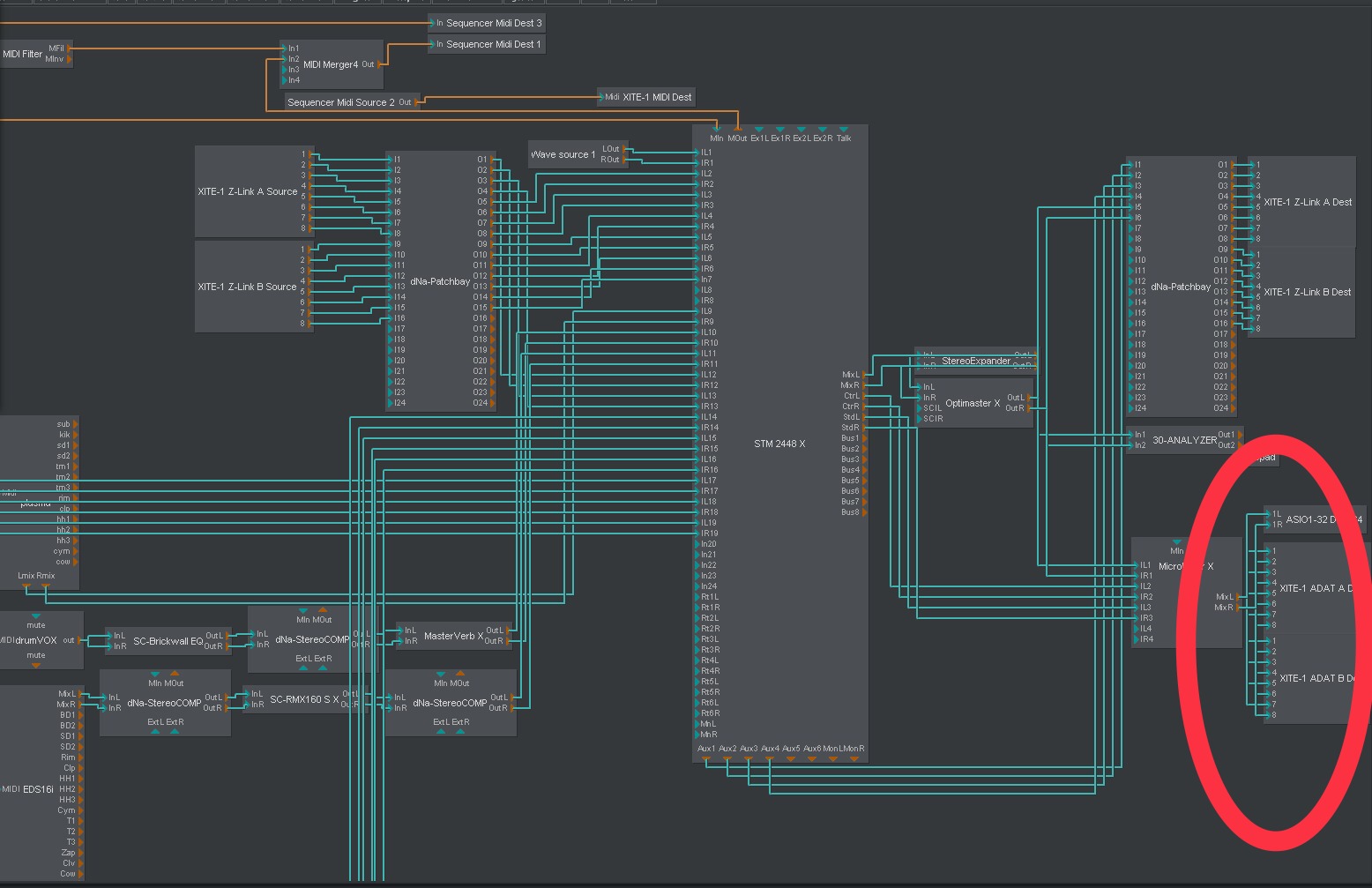

nebelfuerst, I’m wondering how do the connections work in the highlighted area. It appears to be 8 identical stereo channels or 4 identical stereo smux (92khz) going to adat
I mostly configure the adat inputs as 16 mono channels or 8 mono smux (92khz)
If connecting the adat inputs to stereo signals, I have 8 different stereo or 4 different stereo smux (92khz)
I guess I’m wondering how using multiple identical stereo channels benefits adat better than a single stereo channel?

@Berny: The Adat goes to a RMEcard with bitwig under linux. I had some trouble getting the channels in the RME-driver right, so I flooded all channels with signals.

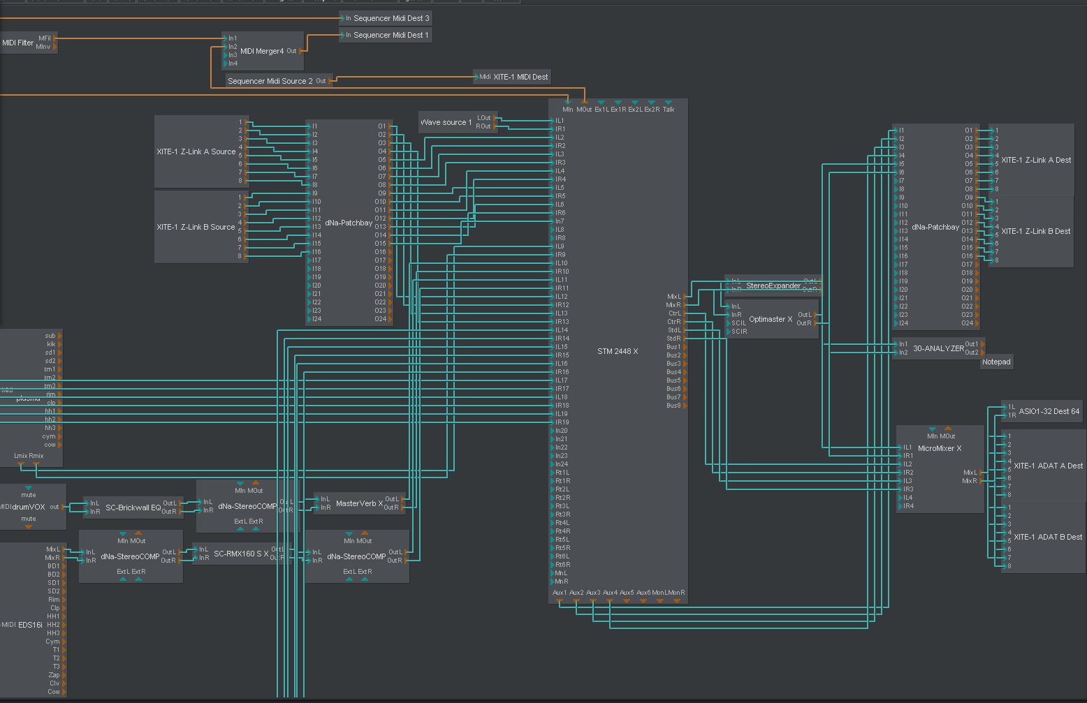

I'm guilty of abusing ctr to extract one channel out of 2448 to an external PC.
Therefore I did't have any need to connect anything to mon.
It works like Spielraum explained. It seems to be a DSP saving mechanism connected to MON, which affects CTR and STD, too.
On first screenshot, there is nothing comming out of STD and CTR.
On the second screenshot, I connected one Mon to a device.
Now STD and CTR immediately deliver stereo output.
