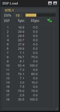

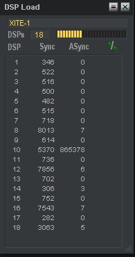

I'm running a setup with lots of reverbs, compressors mixers and some synths on my Xite.
I already had to decrease samplerate to 32, to keep it running.
While DSP load seems to show enough spare power, switching to 44 is impossible, as no placement is found.
The screenshots show no bottleneck to me...so what is the problem ?

Reverbs make use of external processing. Maybe it is the amount of SAT connections which are reaching their limit?nebelfuerst wrote: Sun Dec 05, 2021 1:58 am I'm running a setup with lots of reverbs, compressors mixers and some synths on my Xite.
An fx rack may help

nebelfuerst, looks like "100% async" on one DSP *is* a bottleneck. try moving some effects out of the mixer, when they're used as inserts. When inside a mixer, effects are locked to the same chips that the respective part of the mixer is locked.
And aside from that.. async.. you got a lot of midi processing going? Maybe it's one device eating up all that? Try finding the culprit by removing fx then their parent devices one by one, while keeping an eye on the DSP monitor. Of course, no need to save that project where you've removed so many devices, just reload the original then fix the one thing responsible for that 100% async.
Also, 2 60% devices do not fit on one single chip. Either sync or async.
I hope this helps further your project.

Re: 50% DSP, but no placement possible ?
You are not completely wrong about devices with big poly. Automatic assignment will assign more voices but the project will suffer from
unexpected DSP or SAT overflow if you try to add more devices which is unacceptable.
For me because I have a production system with scope that should work all the time without any type of interruptions, and never ever "collapse" or DSP overflow or SAT overflow I need to have anything under control.
So I create custom patches that fit inside a dsp.
You can try to create a modular patch or sdk poly synth with the modules that allow to fit inside a dsp. I have a number of patches with all the common synthesis methods that allow 16 voices in 44100.
At the same time the project is completely stable, reliable (no need to reload to check if it works... it always works)
Someone can also try to duplicate this patch, assign it to a different dsp and the same midi channel and get some really fat timbres. (16+16+...)
Because I am also a programmer I have made a VST poly-router that does MIDI Voice routing. (sends midi notes to different channels according to voice number) I have played with a 172 voices poly synth this way in scope... Everything manually allocated...
In my case I have to see a dsp overflow or SAT error for years. I mean over 15 years.
It's unfortunate you've expressed having no interest in teaching this. I was interested in your offer before but lacked the means to participate with that machine. Now that I have a machine, it would be nice to share workflows like this with the user-base so that people can elevate their skill level. Otherwise, what use was achieving that level of proficiency if you're not even using Scope now?
