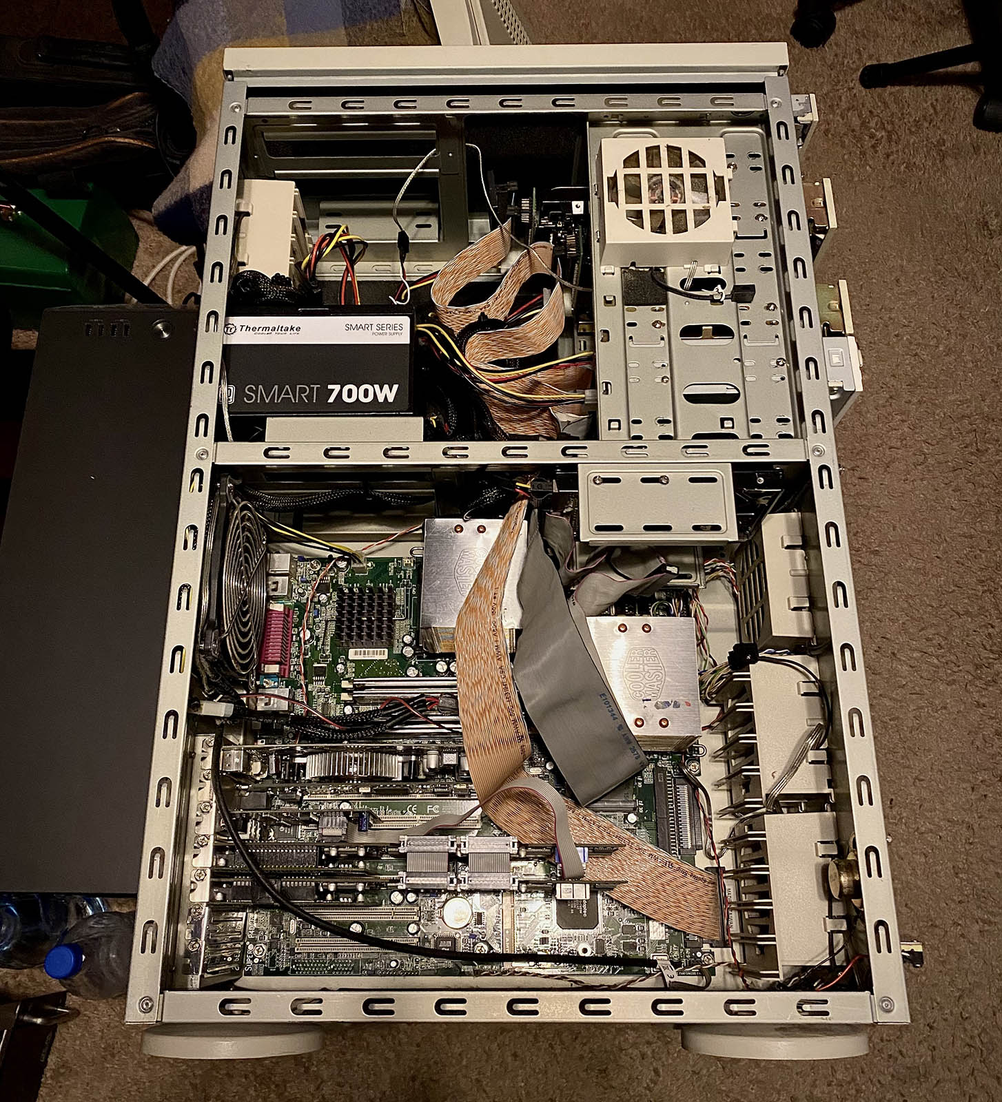

Posts: 7749
Re: New(ish) E3 Xeon build for Scope PCI cards
Ready for retirement after 20 years, this Supermicro P4DC6+ housed my DSP cards reliably for a long time, but it’s time for new digs.

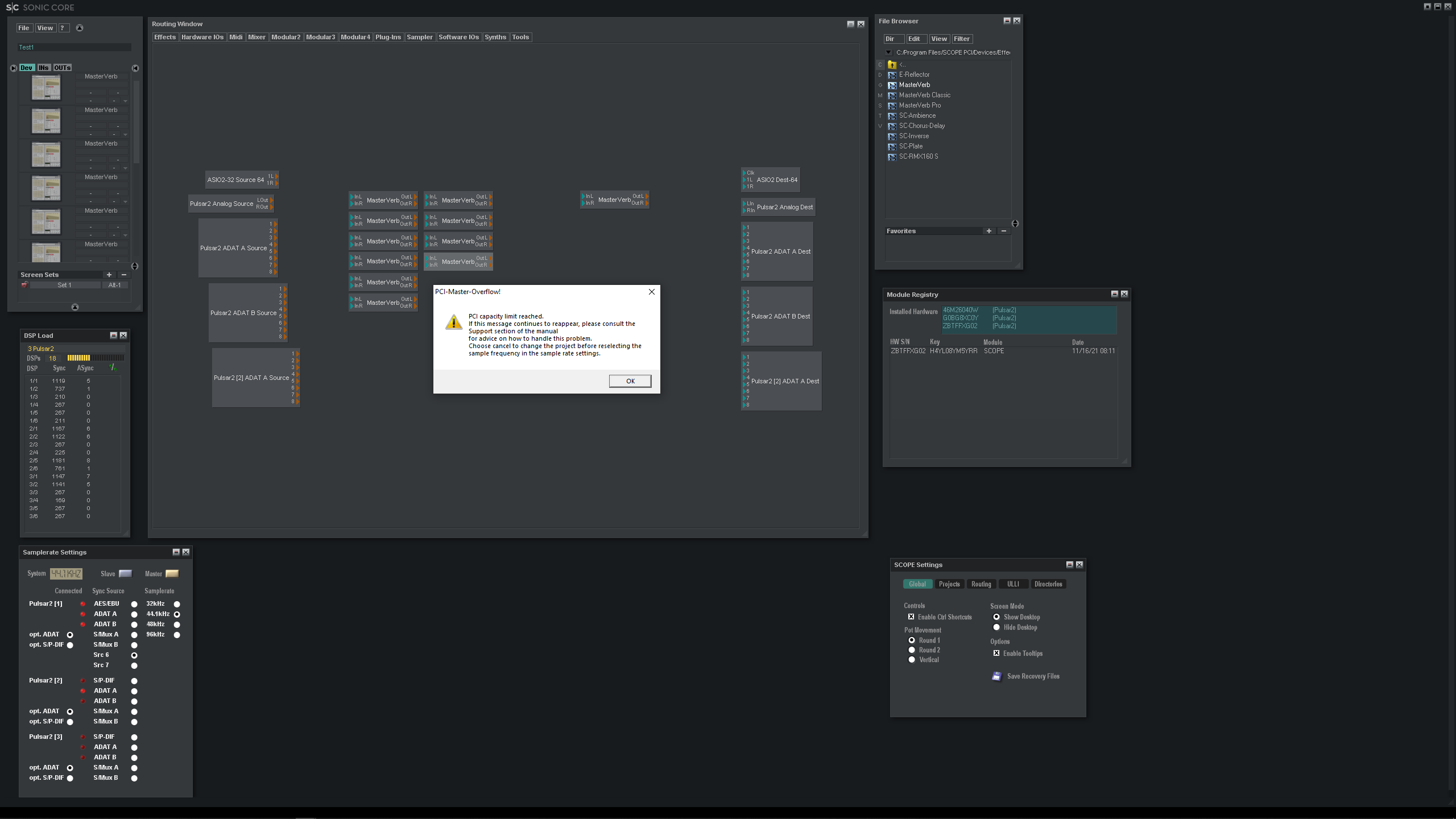

Posts: 7749
11 Masterverbs (9 MV Pro) before PCI limit reached, currently running on two 6 dsp cards.

Posts: 7749
Impressive thanks to Scope, the case, PSU, SSD's and cooling parts (inc. the Fans and the Corsair closed loop cooler) were all from sales. Cooling has improved dramatically over the years, plenty satisfied with this build.
3rd card is back in the Xeon system system (2 of the 3 I'm running are refurb'd at this point). I get 11 Masterverbs is where I hit the PCI limit every time, 10 seems to be the limit for this box without more severe tweaking.

Posts: 7749
PCI limit proof, and again I am probably able to improve this with performance related tweaks in the EFI (BIOS) that I reversed for the time being.
