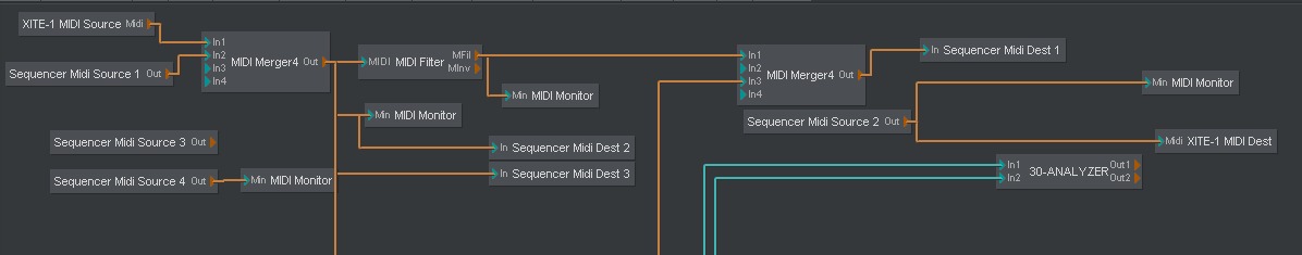

The project shown is not my daily work setup, just stripped down.
My real setup is a complicated mess of 3 PCs, with a self written sequencer.
The Xite Midi flow is shown in the attached picture.
For educational purposes the project should be a simple, clean starting point.
I could change things if I get low level instructions what to change.
The project is attached ( just rename the abletonbasic.txt to .pro). Feel free to improve.
