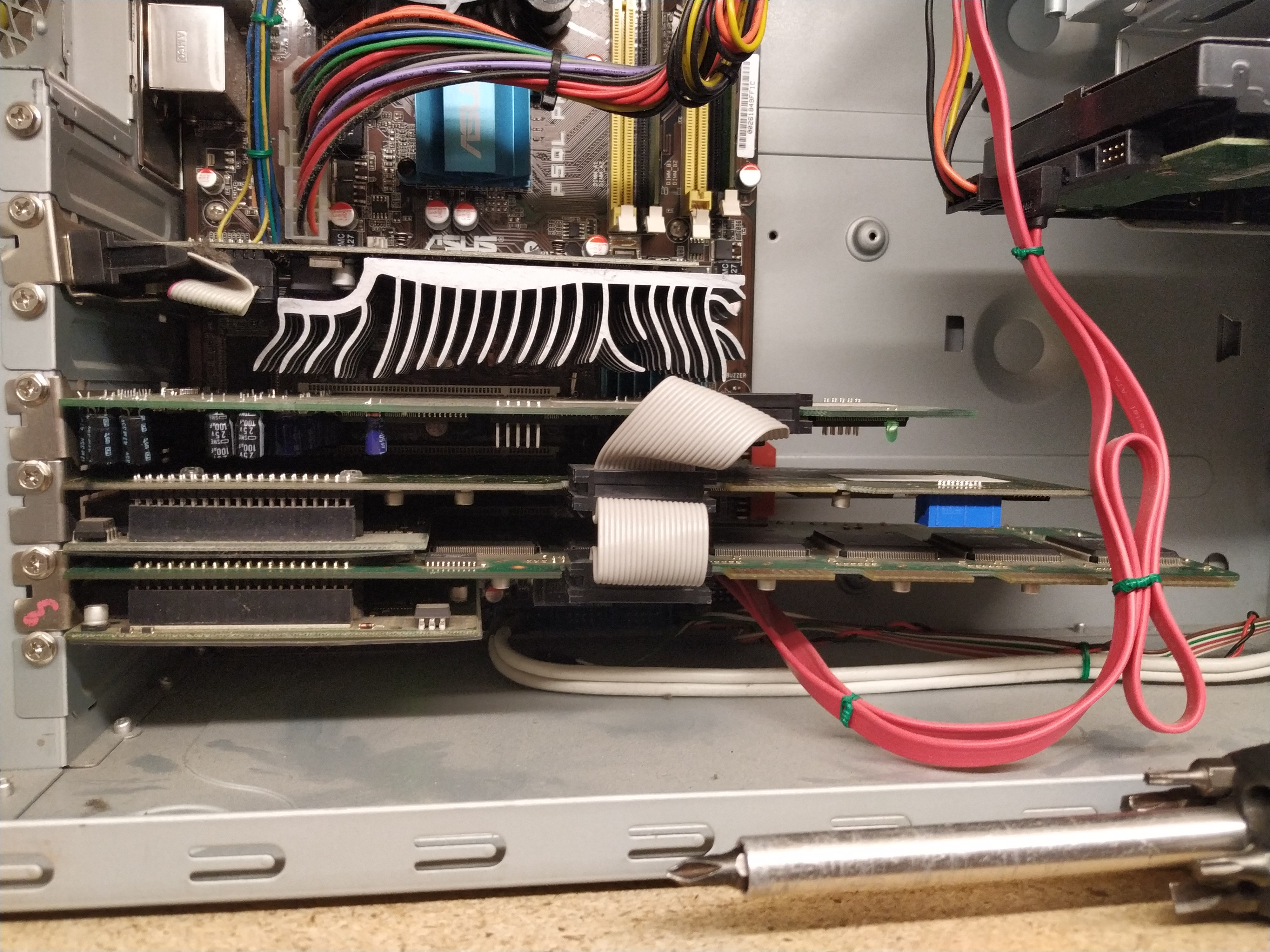

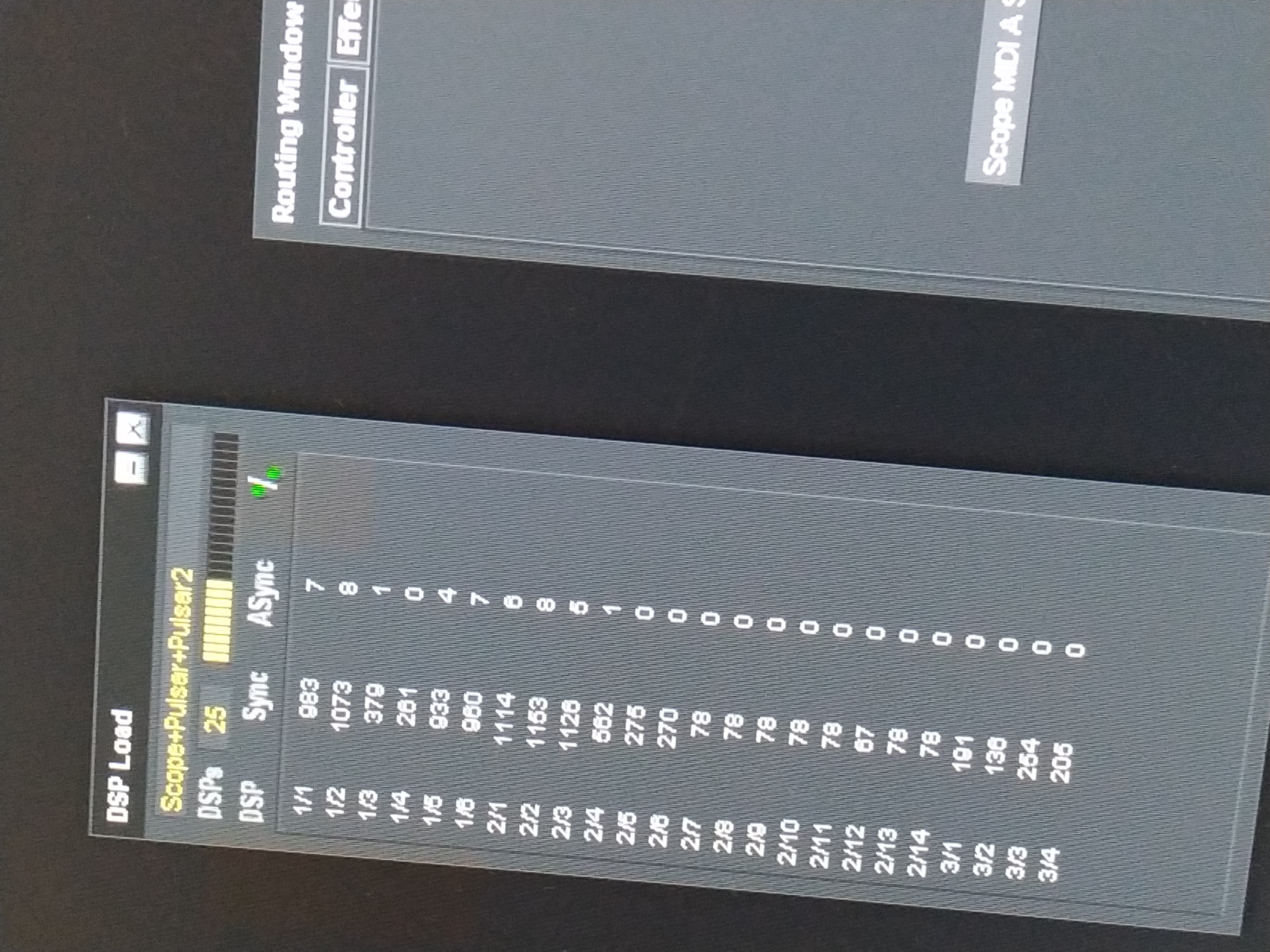

One more question. As you can see on the photos, I have my scope card in the bottom slot, pulsar 2 in the middle slot and pulsar 1 in the top slot.
But in the dsp load panel, they show up in different order (scope, pulsar1, pulsar 2)
How come? Does it affect performance?

it looks like the p2 is first.
i would have it in the last slot(where the 14dsp card is), but it likely won't make that much difference. actually, i would remove the p1 personally.

Re: new system, new questions
I do believe support can help with key transfers, so there's that.
Also, note that the 'PCI slot order" isn't something that the Scope environment has any control over. I did a lengthy post on how IRQ 'steering' ('ala PC 98 Plug'n'Play) changed to 'virtual' IRQs and beyond over the years, but it's a tl;dnr for most people. Short version: The maker of the motherboard (and how they implement board traces, where they connect the PCI slots) and the BIOS/EFI code have the most say here, and if you reset configuration data (sometimes called ESCD) on any post 2008 computer it's likely to change!
So, what we do is simply look at the Scope order for the boards and say 'this card is in THIS slot and shows up in THIS place in Scope', and then swap another card into the 'place in scope:card slot' position as needed. Ie, you could swap the Pulsar2 & Pro card positions and see if that swaps the board order in Scope (the application). How important this will be for your workflow, I have no idea.
The Pulsar2 as master gives you the 2nd generation i/o on the PCI bus, which is good for lower ULLI (asio latency) and reduced PCI usage (versus 1st gen cards). The Pro card being 'seen first' would help you with very large devices (like Solaris), but problems with DSP allocation once you have a fairly loaded project won't go away, it's the nature of how Scope works as GaryB explained above.
It would be more important to get a second STDM cable across that Pulsar2 connector directly to the Pro card's connector underneath it.
