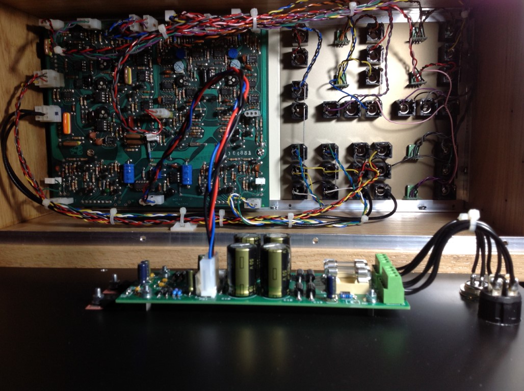

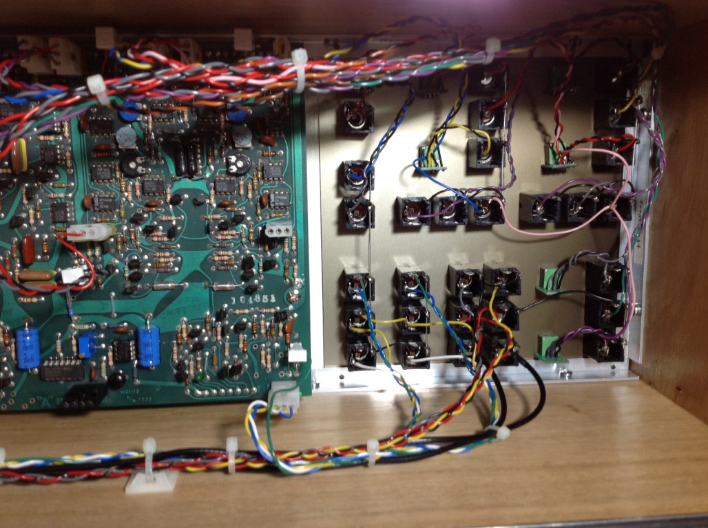

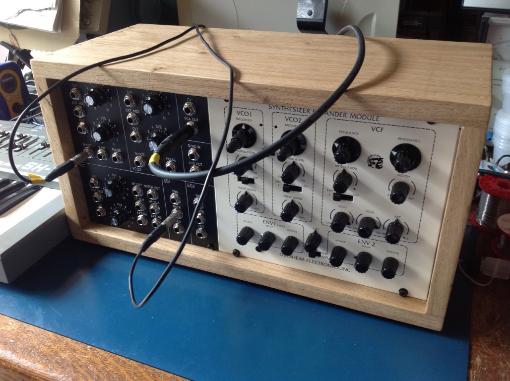

I finally finished my Oberheim SEM project. It took some time due to a few delays and some small issues that needed resolving. But all in all it went quite well, and its now working well and sounds fantastic. Anyway, thought some of you might like to see the end result.
12 A clearer view (Medium).JPG (218.32 KiB) Viewed 3298 times

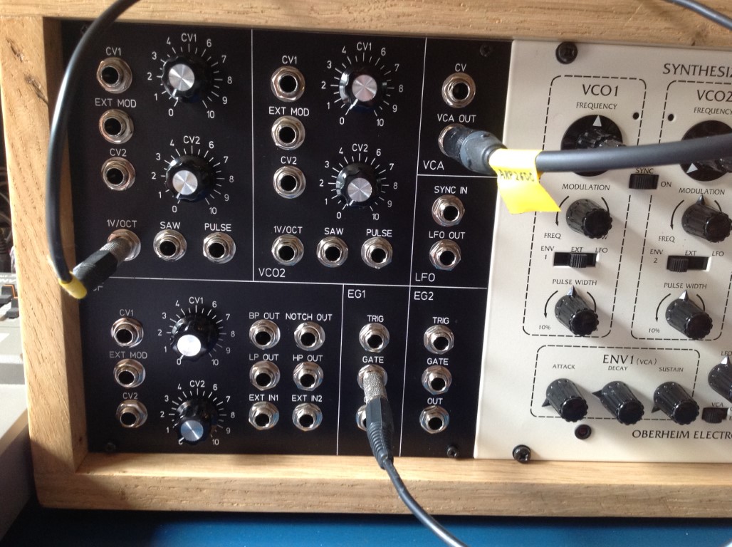

11a Unit connected and working (Medium).JPG (207.6 KiB) Viewed 3298 times
11b Unit connected and working (Medium).JPG (220.18 KiB) Viewed 3298 times
11c Unit connected and working (Medium).JPG (201.74 KiB) Viewed 3298 times

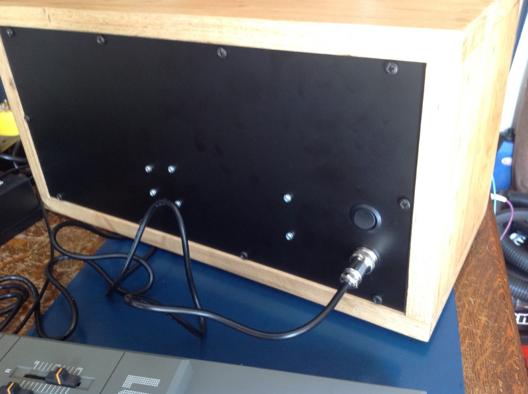

10e Back Panel fitted & connected to a Yamaha PA-10 linelump (Medium).JPG (146.91 KiB) Viewed 3298 times

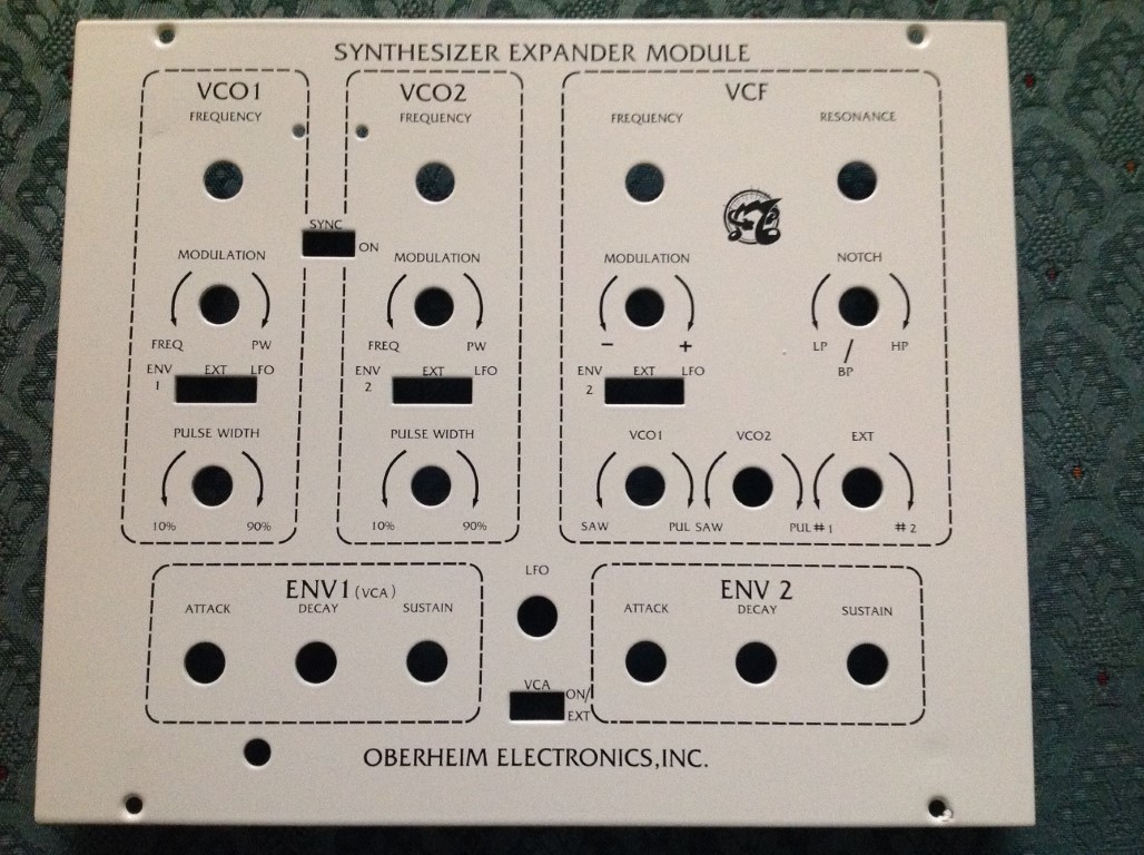

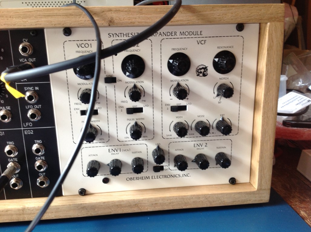

The SEM panel when I first bought it, and after getting it silk screened
1a SEM Front panel- As it came from seller (Medium).JPG (188.06 KiB) Viewed 3297 times

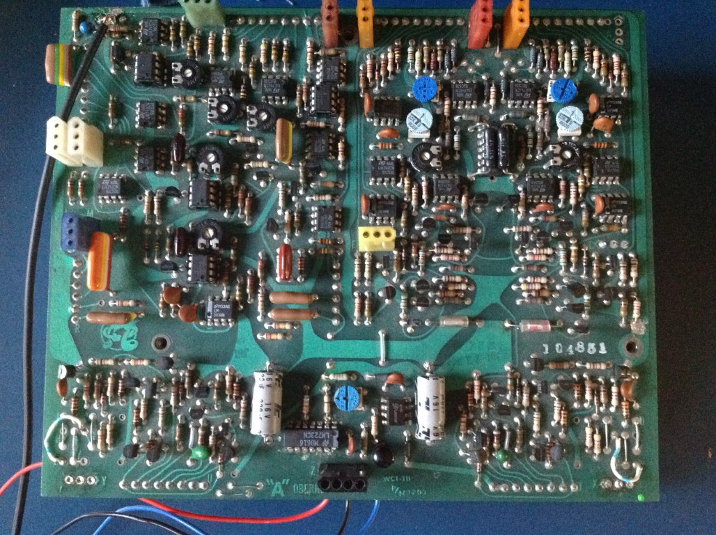

1b SEM PCB - As it came from seller (Medium).JPG (313.76 KiB) Viewed 3297 times

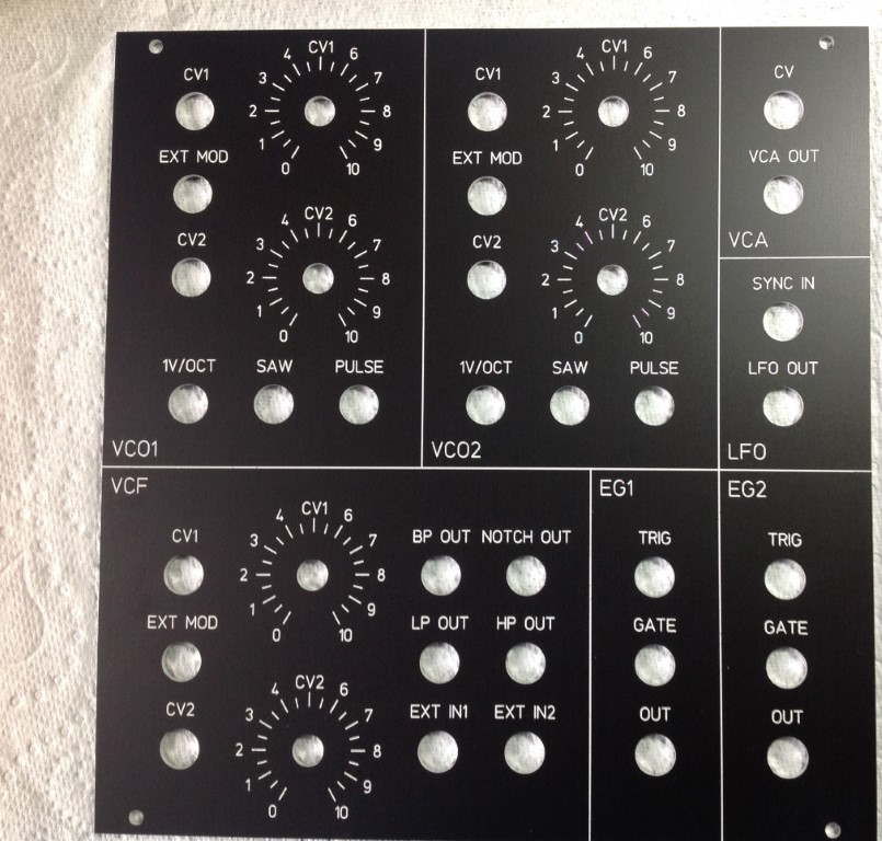

4 SEM panel after Silk Screen (Medium).JPG (222.91 KiB) Viewed 3297 times

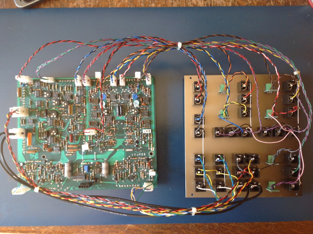

5 IO Panel before wiring (Medium).JPG (143.03 KiB) Viewed 3297 times

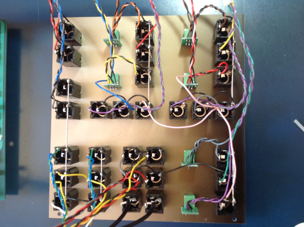

Wiring it up
6a IO Panel after wiring - before swapping the 2 purple wires on bottom right VCF CV2 pot which are incorrectly placed in this photo (Medium).JPG
6a IO Panel after wiring - before swapping the 2 purple wires on bottom right VCF CV2 pot which are incorrectly placed in this photo (Medium).JPG (185.4 KiB) Viewed 3295 times
6b SEM & IO Panel after wiring - before swapping the 2 purple wires on bottom right VCF CV2 pot which are incorrectly placed in this photo (Medium).JPG
6b SEM & IO Panel after wiring - before swapping the 2 purple wires on bottom right VCF CV2 pot which are incorrectly placed in this photo (Medium).JPG (235.16 KiB) Viewed 3295 times

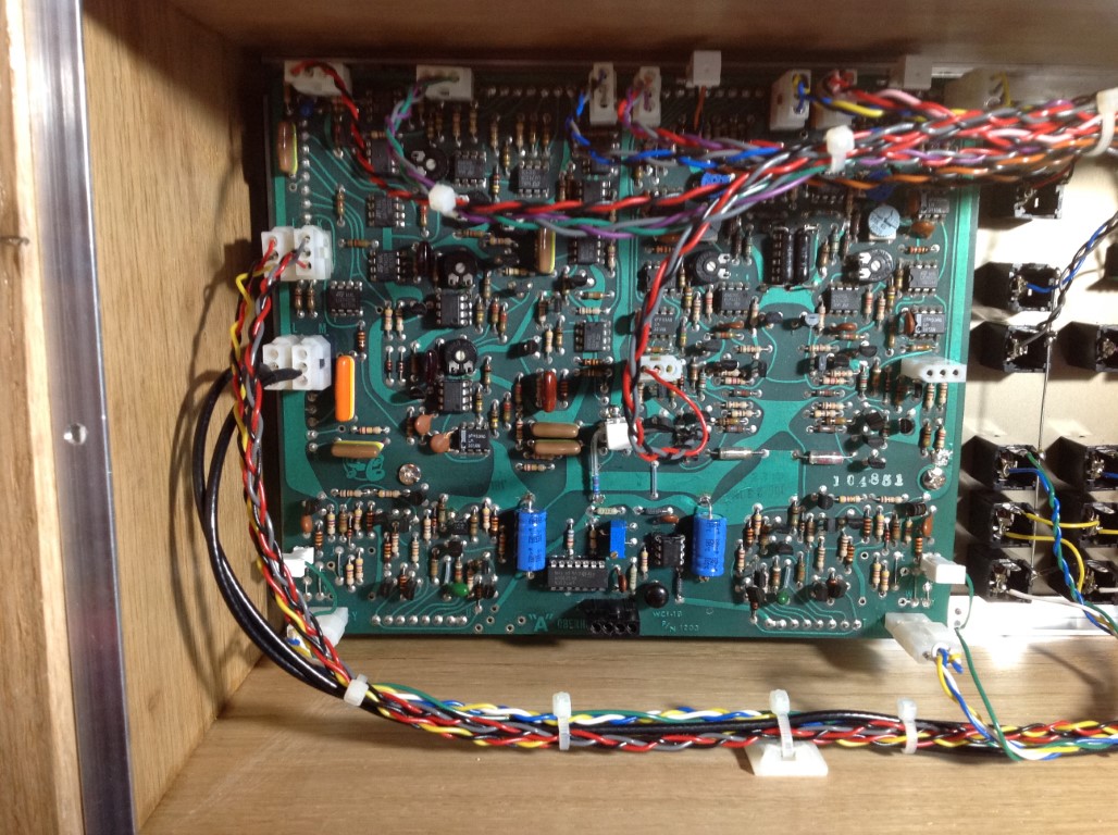

10a SEM panel installed & connected (replaced 220uF axial caps, transistor & regulators) (Medium).JPG
10a SEM panel installed & connected (replaced 220uF axial caps, transistor & regulators) (Medium).JPG (255.72 KiB) Viewed 3295 times
10d SEM & IO Panels fitted with back panel open (Medium).JPG (222.19 KiB) Viewed 3295 times

i would have done the back as a door that can be opened easily (like...a door, lol) rather than screws, but i suppose you don't go in there often to change jumpers or add modules...
That's what I have done on my modular and it is really cool not to have to unscrew everything (but it is not complete as is yours, so i still need easy access).

Spacef, yes I did think about making the back panel open on a hinge like a door, but I think in the end I was in too much of a hurry to finish it. :) I remember you posted up some photos of your modular a short while ago so I'll have another look at how you did that. I don't really need access to the inside of this unit except for calibration or repairs but if that changes I may try to work out how to add a hinge. :)

Thanks
No, the first time I tuned it on it didn’t work at all, but luckily I found out quite quickly that it was only a transistor that had blown and had taken down the negative rail, probably due to one of the caps failing. But it was an easy fix, just replaced those parts and for good measure the other cap since they were over 40 years old.
second time on it worked fine :)
