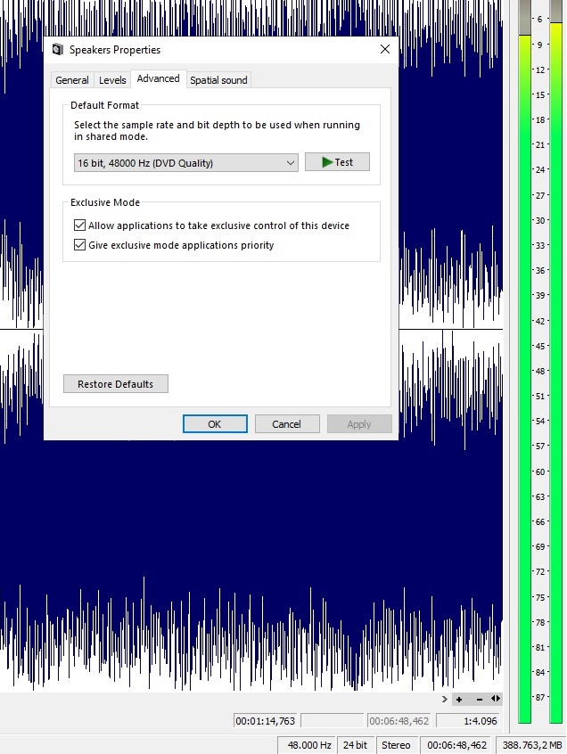

You may have to set the Win WDM drivers (in multimedia setup) to 48khz, too, assuming the wave editor is not on Asio).
And possibly Soundforge to that rate as default, if most of yor files are 48khz.

astroman wrote: Fri May 28, 2021 12:53 am You may have to set the Win WDM drivers (in multimedia setup) to 48khz, too, assuming the wave editor is not on Asio).
Thanks Astroman !
Yes, wave editor is not ASIO, Cubase is using it.
I don't remember to change or that i need to check multimedia setup.
Leaving setup at 44kHz works fine. I can run Cubase and edit wavs in Soundforge together.
Soon, when i change to 48kHz, Cubase is running, but wavs in Soundforge stops to play and Soundforge is reporting missing device.
Since i have checked my last project, i have all wavs in 48kHz, so i'm sure i have edit them together while running Cubase + Soundforge and they played at 48kHz samplerate.

Ok, finally, it's working.
Like already Astroman suggested to change in multimedia to 48kHz, didn't worked yesterday, i have played again with settings today.
-full security access to C: (Users)
-run as administrators (Scope, Cubase, Soundforge)
and changing multimedia-advance settings.
