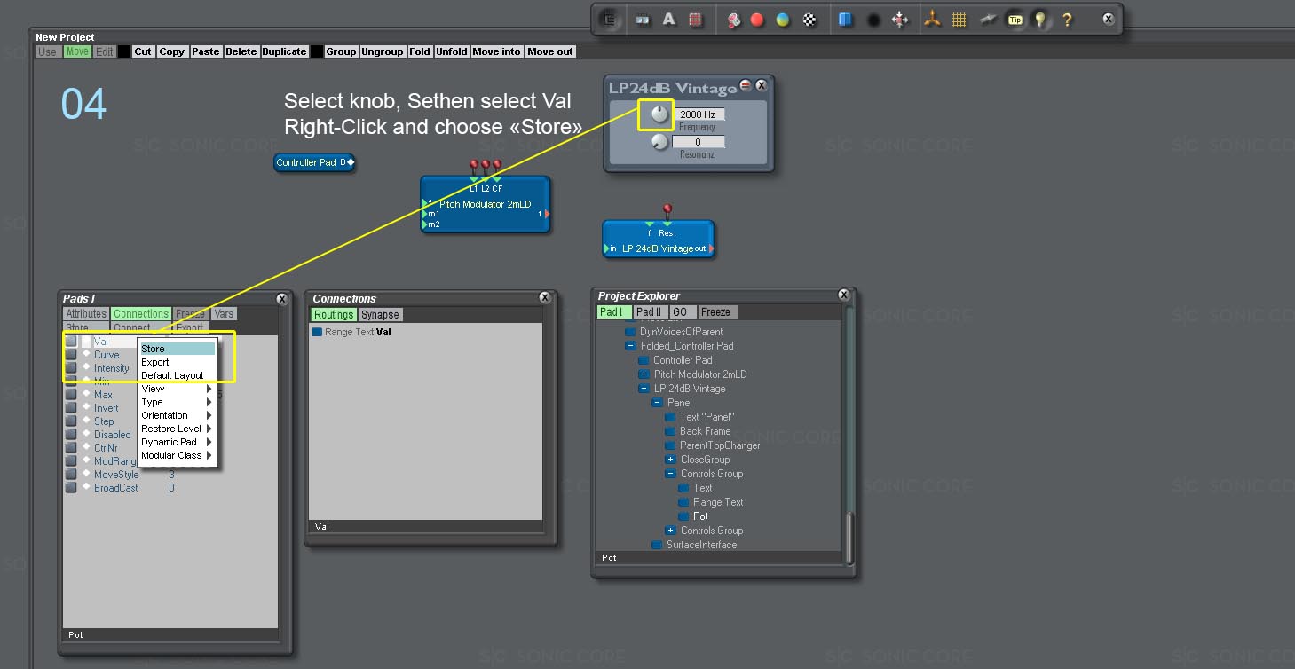

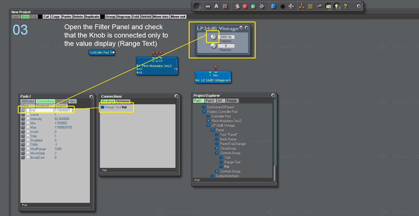

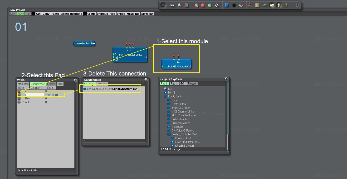

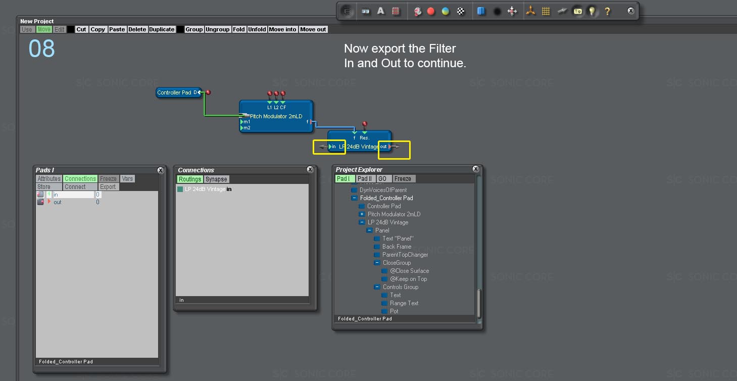

I'm stuck again at 14:45.
Pressing the freq-knob of LP24 doesn't show Rangetext val at connections, as on your video.
Pressing store and connect doesn't add Pot Val to the connections.
Are this differences, I should care about ?
spacef
Posts: 3356
Re: TUTOR VIDEO - Make a synth in Scope SDK in less than an hour
Post by spacef »
Here is some help (2 posts)
You can download all images to see them better from your pc
or right click and "open image in new tab"
I also added more text/info at the end of the next message (under the images)
NB: to delete the connection, select it in the connection list and hit "Del" key
