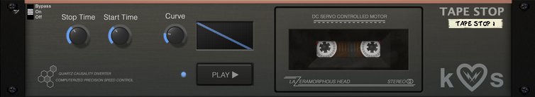

For simulating tape speed behaviour there's also dedicated plugs such as Kilohearts Tape Stop (MIDI triggered IIRC):
Kilohearts TapeStop
Kilohearts TapeStop
kilohearts tape stop.jpg (16.98 KiB) Viewed 22751 times
But likely I wouldn't be using that to thicken a rhythm guitar. :lol: :lol: :lol:

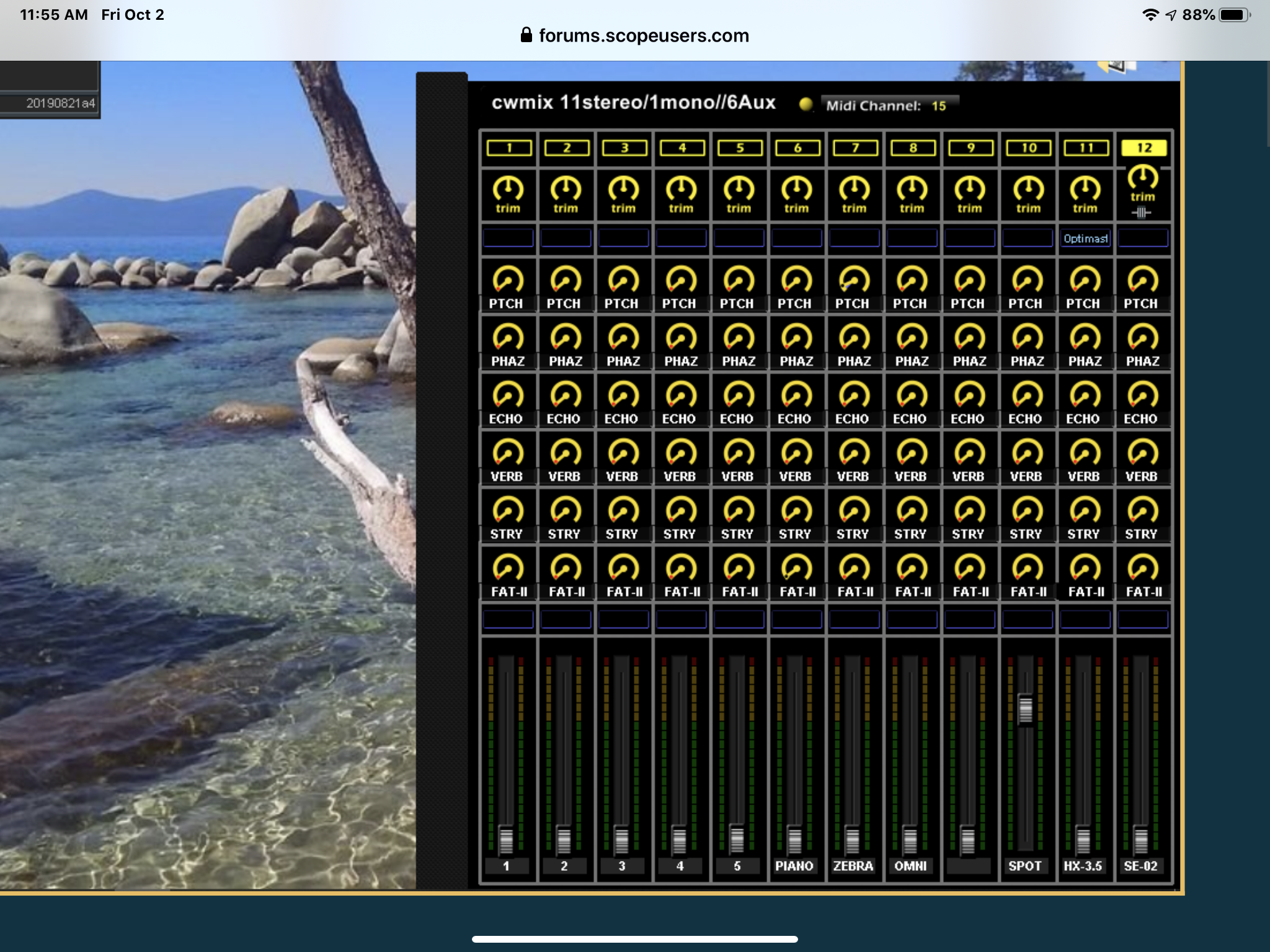

I tried combinations of Omnisphere, Kontakt, PTeq or Zebra with Scope but it’s just not doing it for me.
With 6 AUXs we can blend effects without adding to much gain due to the nature of AUXs.
I like my AUXs like this recently.
dNa PTCH
Scope Phaser
dNa Prime Time
Scope Master Verb
Strymon
SpaceF FAT-II
FAT-II using Algo 2 w/ 100% Valve.
Nice to add some low end or separation since it’s the last AUX.
In all honesty I don’t need the Strymon but it really does the trick for colors you can’t get by blending Prime with MasterVerb.
I like MasterVerb for decent room/stage Verb. Authentic creation of space where Strymon can be big everything.
Nice using a splash of dNa Prime Time pre MasterVerb, acts as the early reflection when set to 150-200 msec.
