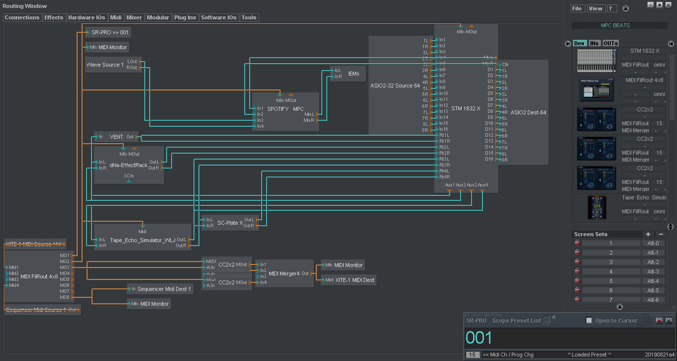

Been 9 years since I tried to record anything, even then I'm very limited and have trouble focusing on perfection and editing.
I would simply hit record and play all the way through.
Now I got me an Akai MPC Live and the software is actually a DAW. I was trying to record it in it's plug in state and drove me to Jager sessions and anger.
Recently Akai released free software that's simpler than the full fledged software, so I'm going with 8 x MIDI Tracks and 2 x Audio Tracks until I learn my way.
Seems to have endless outs and ins so I just want to do 8 stereo (16 hard panned mono) tracks in and out of DAW.
STM1632X seems to be capable of direct and mix outs simultaneously.
I monitor with IEMs and Mix Out of STM.
Am I doing this right so far?

Well depends on what Spotify MPC is - if that's a real or virtual MPC looks like your mixing it with premixed DAW/STM output - which is OK. But if your MPC is hardware or a VST might be better feeding its output into your DAW, then mixing all in STM. The way it is now, any bus compression, other finalizing and send FX done in your DAW or STM wont be applied / available to the MPC.
In fact, with a virtual MPC (VST) I'd be breaking out each of its tracks separately, mixing in DAW or STM so each MPC part can be treated with separate EQ, FX etc.
I played with a virtual MPC ( https://mpcsoftware.akaipro.com/ ) but I didn't like the stock patterns / sounds and couldn't be bothered downloading more so I used existing EDM Rack Extensions in Reason instead which was for me a much faster process than the MPC learning curve.

you could be.
i don't like to decide if a channel is stereo or mono, and how i want to assign outputs until i am ready for the session. it's no big deal to set it up if the basic template is in place, but if one of those channels becomes stereo, it might really mess with the direct out assignments. having to remove and reconnect cables is more trouble than just connecting cables.
i prefer the STM2448 for recording because it has 8 assignable recording busses which saves a lot of time patching. it also has a control room out which can monitor mix out, monitor out, or aux outs. yes, it has a dedicated monitor out. i would connect the iems to the control room out. it can listen to the nix out, plus it has a volume control, so you don't have to turn down the mix to adjust your monitoring level. this is important if you are recording the mix out.

I was hoping you’d chime in and set me straight.
I should’ve known because I used those Busses before but the whole control room thing is new to me.
I shall proceed accordingly, Ankyu.
Bad habit of mine, even though I’ve the XITE-1 is to use as few connections and least DSP.
I have the XITE-1 Damn it, move on....

If the MPC has multiple analog outs, can be fed into A16 then XITE via Adat => Asio Dest => DAW => mixed / tracked w/ other DAW material => back to XITE for further STM mixing and/or mastering.

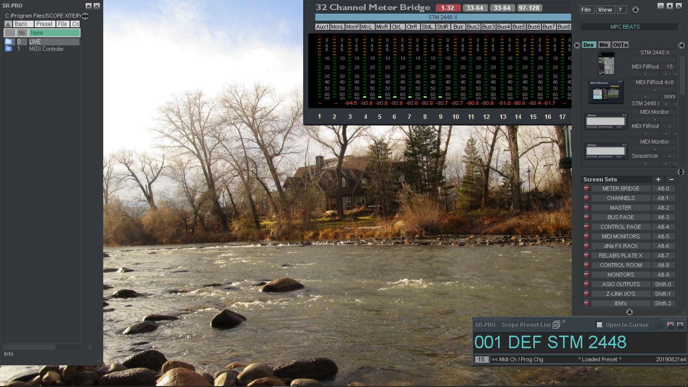

Thanks, I'll check it out.
GaryB's advice was spot on.
Check out the Screen Set options, flawless operation
Routing Window no longer works as a Screen Set but I don't really need that.
