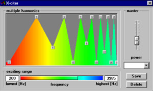

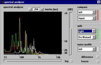

Some screenshots from Osiris. Maybe it was doing some harmonic resynthesis? The high end tended to sound artificial at anything beyond minimal levels. The low end really had a resonant kind of tone that felt more meaty than boomy. I recall that exclusively odd or even numbered harmonics would often be best, but no way to tell which without trialing some settings.
- triple3.jpg (21.91 KiB) Viewed 5005 times
